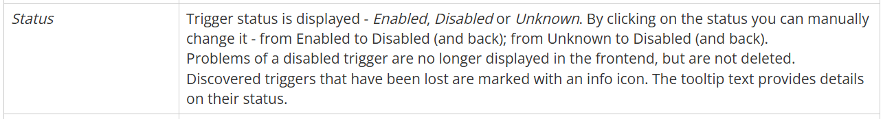

    When you disable a trigger or item:
    - The frontend hides its problems
    - but the problem events stay in the DB, so problem.get still returns them. This is clearly described in the documentation on triggers:
    From official Zabbix documentation (Zabbix 7.4) https://www.zabbix.com/documentation...hosts/triggers
    ​If you need the API to provide the same data as the Web UI, you need to repeat the logic on your side:
    1. First, call problem.get as you do now.
    2. Take objectid (triggerid) from the results and do trigger.get with the filter status: 0 (enabled) and, if necessary, selectHosts to check that the host is not disabled.
    3. When integrating with Jira, only leave problems whose triggers/hosts are enabled.
