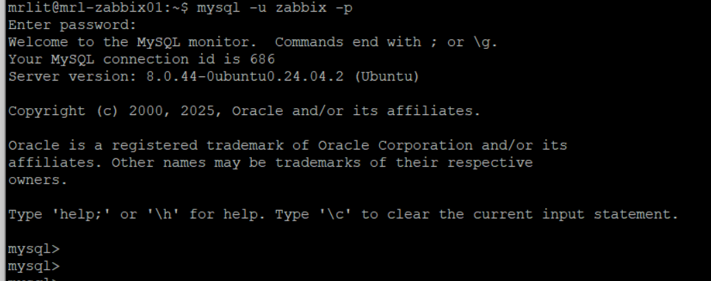

    i can log into my sql using the zabbix user and the password that i have set:

    • chrisbirley
      • Mar 2025
      ok, so further update, it looks like this killed the web front end, but ive re entered the password in the php file, and also the config file, and can now get back into the system. however the front end is still telling me that the server isnt running, and wont give me any information about server version etc. now when im looking in the server.log file i get the following:
