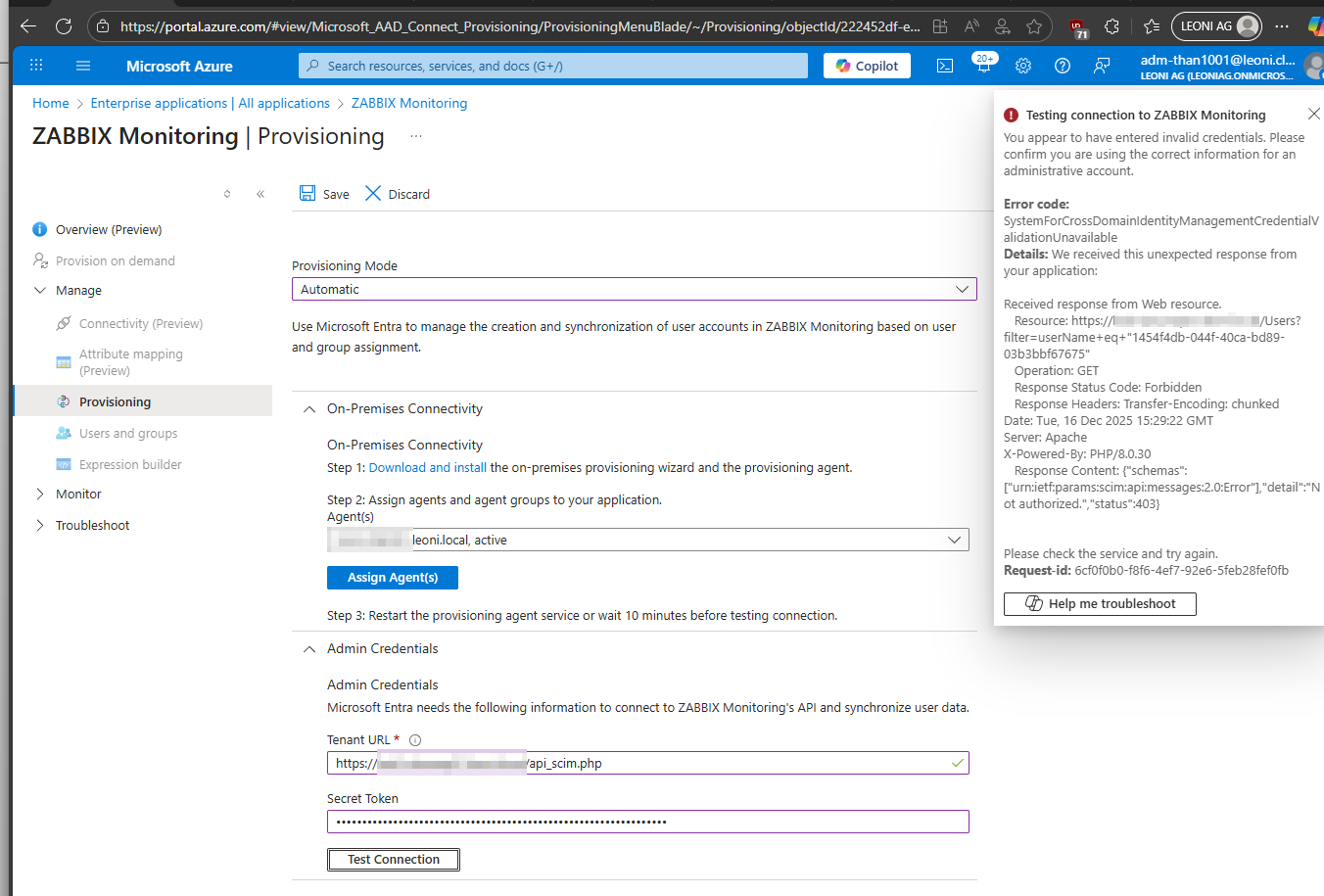

    Hey there,
    currently i have some trouble setting up SAML with SCIM properly. SAML itself is already working properly. Also the JIT Integration is working as expected. Finally i would like to setup SCIM as well.
    I followed this Guide 12 SAML setup with Microsoft Entra ID
    - In Users => Authenticiation => SAML the Checkbox "Enable SCIM provisioning" is checked.
    - I created a dedicated user named "Entra-SCIM-Provisioning" and gave them the role Super admin
    - I created an API token, assigned them to this user and saved the key
    - To allow access to the API i use an on-premises SCIM agent
    Finally i configured the enterprise application as shown in the screenshot below. If i click on Test Connection i see the error - which is also shown in the screenshot below
    Click image for larger version  Name:	scim-prov-error.png Views:	2 Size:	159.6 KB ID:	509768
    I already confirmed on my firewall logs that there is communication between my on-premises scim agent and the zabbix instance.
    I am also able to see the following in the webserver access logs as soon as i click on "Test Connection"
    10.216.107.132 - - [16/Dec/2025:15:32:46 +0000] "GET /api_scim.php/Users?filter=userName+eq+%22ff7298be-96e2-4c5d-a9b7-e0faeb7426fc%22 HTTP/1.1" 403 99 "-" "-"
    I can confirm that the API Token itself seems working. If i try this from the server i got a response.

    Doing the same against the api_scim.php endpoint again i get a 403
    Any Tips are appreciated. Does anyone have an idea what i can further check?

    Was able to fix it. While doing several tests together with my favorite LLM i was able to confirm that PHP was not pass through my auth header proberly.
    Adding this to my apache config fixed it:
    SetEnvIfNoCase Authorization "(.*)" HTTP_AUTHORIZATION=$1
