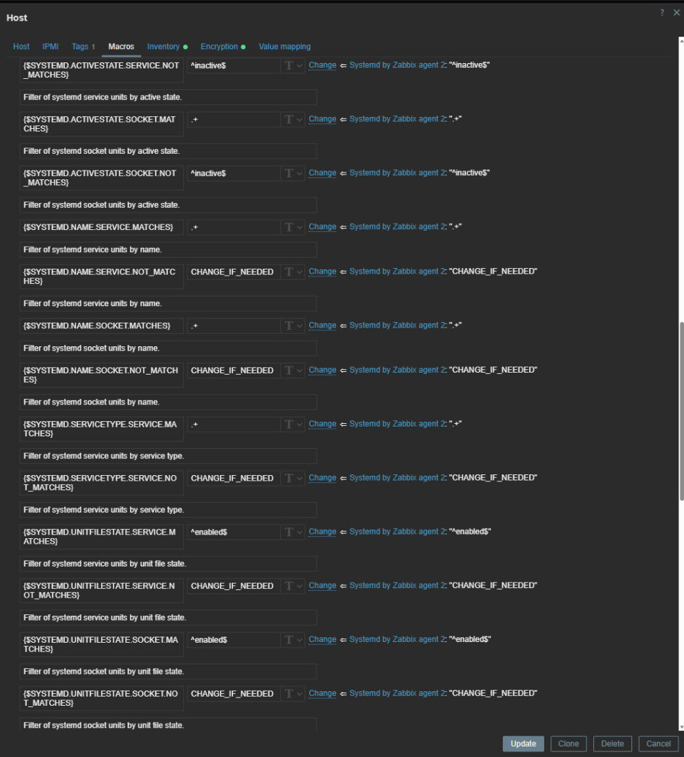

              How are the systemd macros configured for the hosts and/or templates?
              https://git.zabbix.com/projects/ZBX/...Frelease%2F7.4
              Markku
              • Backstage24
                • Oct 2019
                • 11
                All macros are configured by default. There are no configurations on the host. And also on both hosts the same configuration.

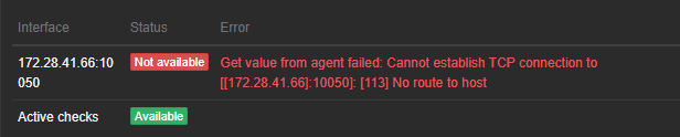

                      • Backstage24
                        • Oct 2019
                        • 11
                        Yes, that's correct. The error only became apparent after the correction was made to the zone firewall.
                        This error was resolved with the correction of the firewall on the target system.
                        I sad, this was a strange issue... and it is.
