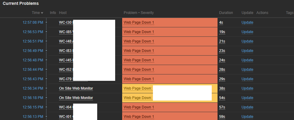

    Off and on again I'm having trouble with a LOT of Web Scenario tests failing. For example all was well this week until today (edit; this has happened in the past but I haven't been able to log in and diagnose while it was happening until today) and they are failing many tests at one time. Some facts;

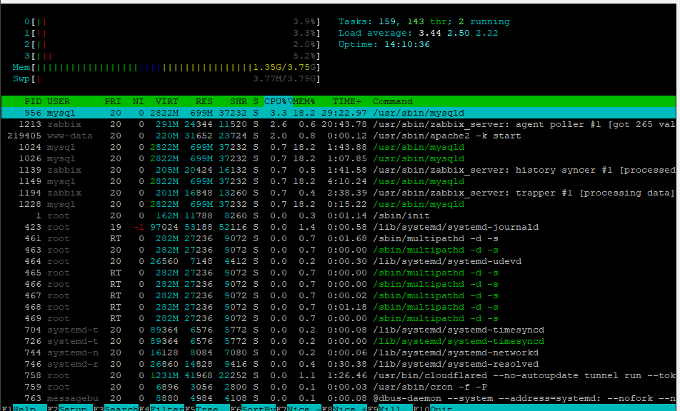

    9. HTOP looks fine, not out of memory or CPU

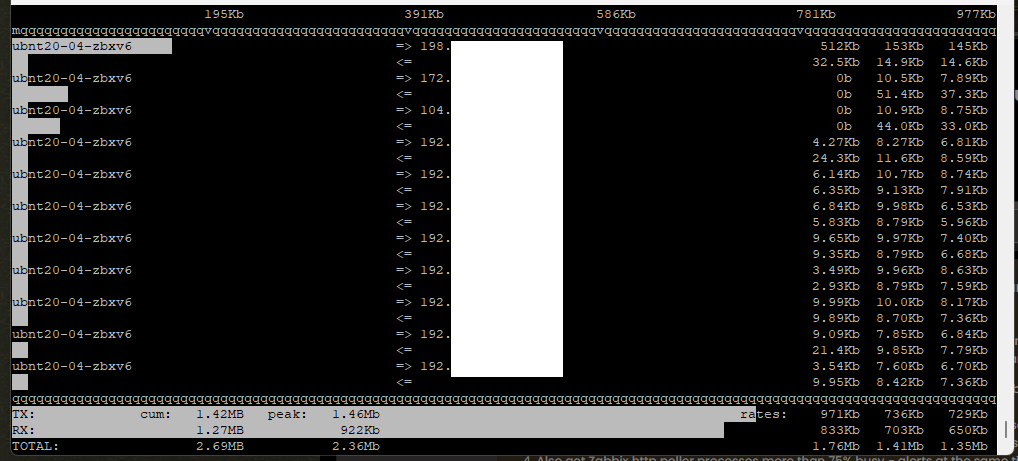

    11. iftop looks ok too, like it's no sweat on network traffic below.

Name:	Screenshot 2026-01-28 135459.png
    Click image for larger version  Name:	WebPageCheckFail.png Views:	0 Size:	47.2 KB ID:	510720 Click image for larger version  Name:	Screenshot 2026-01-28 132319.png Views:	0 Size:	28.5 KB ID:	510722

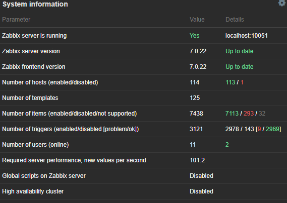

      VM has 4 CPU and 4GB of memory. MySQL db. Doesn't appear to be running out of resources per htop, iotop, iftop. I'm fine throwing a little more RAM at it.
      It's "only" monitoring ~100 servers and ~130 ish web pages, certainly not huge.
Name:	Screenshot 2026-01-29 100940.png
