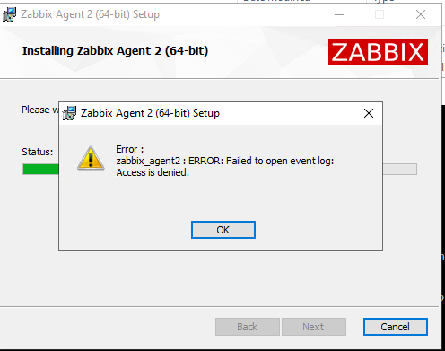

    Hi All,
    We have facing a problem with installation of Zabbix agent 2 7.0.24 MSI and archive package as well on multiple Windows server 2022. It is the same issue on all Windows servers. (link for agent: https://cdn.zabbix.com/zabbix/binari...64-openssl.msi)
    Error message:
    "zabbix_agent2: ERROR: Failed to open event log: Access is denied."
    We have tried with administrative privileges and also from elevated command line. No success yet.
    Do you have any suggestion how to move on with this problem?
    Thank you very much for your kind help!
    Regards,
    Zoltán
  • zhelembai
    • Apr 2026
    Another advancement that we finds in this case, that only happens on Windows server 2022 which are upgraded from Windows server 2019.

      Hello zhelembai
      did you find something
      exactly the same problem for me
      Thanks in advance
