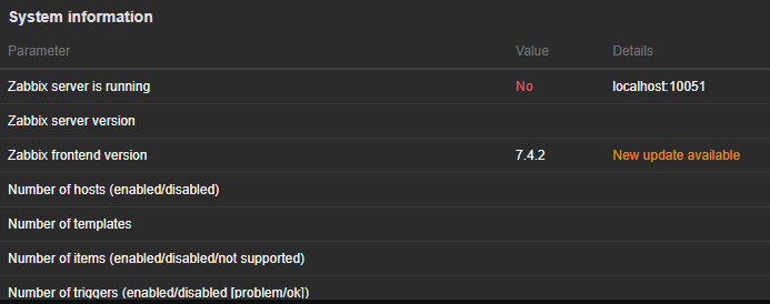

    Hi there.
    I'm trying to troubleshoot my split zabbix environment. I've had everything up'n'running on all-in-one zabbix srv. Then I created separate servers for frontend and DB, created empty DB and restored backup into it. I guess I tweaked all conf files as expected, reconfigured GUI using IP/zabbix/config.php - went smoothly, no issues connecting to DB...
    Click image for larger version  Name:	image.png Views:	0 Size:	11.3 KB ID:	512565
    Anything else to check?
    zabbix 7.4.2 + postgresql 17
    PS. Here's some issue connecting to DB in logs (kinda weired since gui configurator shows no issues):
    801:20260410:100002.350 database is down: reconnecting in 10 seconds
    801:20260410:100012.366 [Z3001] connection to database 'zabbix' failed: [0] FATAL:  password authentication failed for user "zabbix"

    Allright first update... It seems I had a typo in zabbix_server.conf in db password.
    Now /var/log/zabbix/zabbix_server.log shows something new:
    5545:20260410:102910.144 cannot use database "zabbix": database is not a Zabbix database
    5620:20260410:102922.357 Starting Zabbix Server. Zabbix 7.4.2 (revision 7aa4e0782fe).

        What I did was:
        - create local db dump (downer server):
        # pg_dump -h [ZABBIX SERVER] -U [ZABBIX DB USER] > /tmp/zabbix_dump.sql
        - moved dump file to destination server
        - removed all temporary/test zabbix postgres DB's using 'drop database xxx'
        - created new empty DB named zabbix:
        postgres=# create database zabbix;
        - restored dump file on a DB:
        # sudo -u postgres psql -dzabbix -f /tmp/zabbix_dump.sql
        - restarted all related services like zabbix-server, agent, postgresql etc.
        - using http://zabbix-server-ip/zabbix/setup.php reconfigured initial setup (went flawlessly connecting to DB zabbix).
        Web gui loads, login screen accepts credentials (assuming stored in DB anyway), I can see created custom dashboards, maps etc yet with warning 'zabix server is not running' at the bottom...
        What am I missing?

          • 5004
          If you split up a all-in-one server to 3 separate ones (db, frontend, server), then you are probably missing a connection from frontend server to zabbix server 10051 port.. Frontend does verify, if backend is running..
          • Jaceqp
            • Mar 2026
            • 19
            Frontend + server is one server. Only DB is being moved to another one. I think I got it solved cause I had both db name and db schema variables set in zabbix-server conf file. I hashed out dbschema and that solved the issue.
