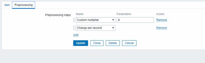

    • GDefina
      • Sep 2017
      Solution!!
      Must add in the tab 'Preprocessing' the step 'Change per second' after the step 'Custom multiplier 8'.
      See the attach.
      Bye!
