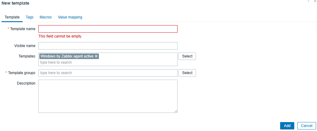

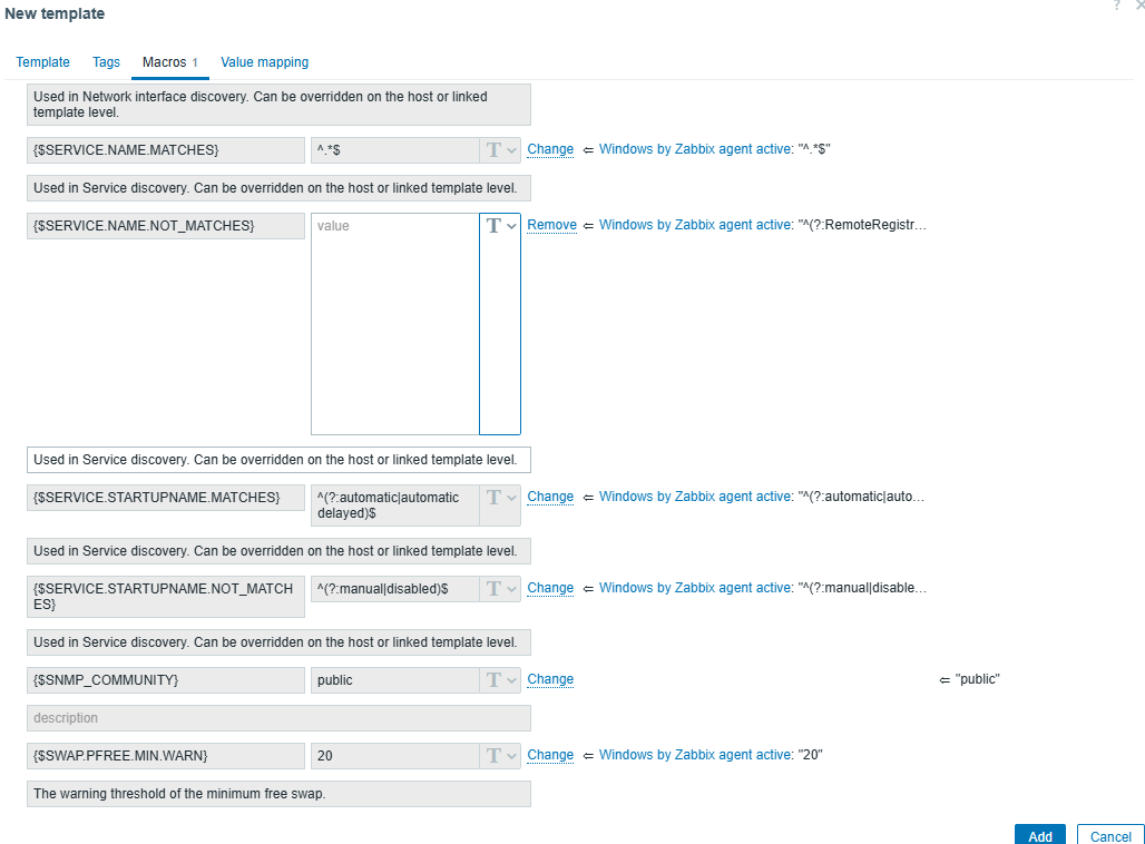

    It should work if you create new template, link existing Windows by Zabbix agent active template to it, change the macro under inherited macros and afterwards link ONLY your new template to needed hosts.

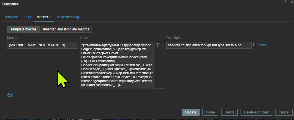

    Alternatively you can clone the existing Windows by Zabbix agent active​ template and afterwards change the clone however you want and link it to hosts.
    ​'Template macros' tab displays only macros which exist on this specific template, 'Inherited and template macros' shows both macros which are inherited from above and macros which only exist on this template.
    There are three levels of user macros in Zabbix by level of inheritance from top to bottom: Global -> Template -> Host. So all templates and hosts inherit global marcos, all hosts linked to specific template inherit macros from this template. In case of linked templates, new template also inherits macros from existing linked template. Macros can then be manually overridden on lower levels - so global macro can be overridden on template and host level, linked template macro can be overridden on new template and host level, it is done by either changing the value under inherited macros tab or by specifying the same exact macro under template/host macros.
