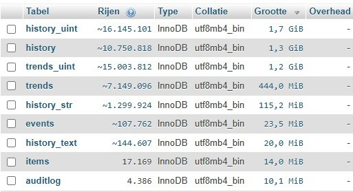

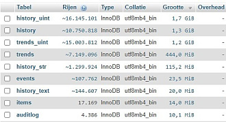

    We have a small zabbix server running for quite some time, its hosted on a Ubuntu 24.04.2 LTS; MySQL ; Zabbix version 7.0.7, Running as VM on a Windows Hyper-V.
    About 140 hosts monitored; about 10.500 active items; with a nvps of about 50.
    The server has been running fine, no problems at all, low io, nice usage, nothing to be concerend about.

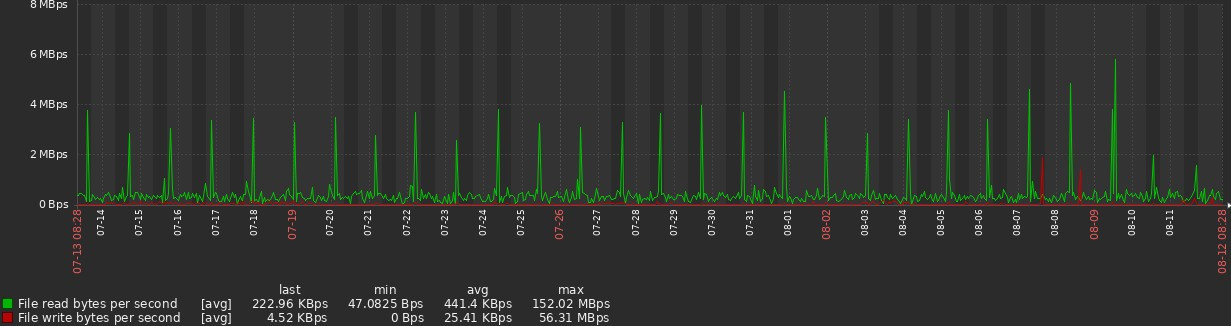

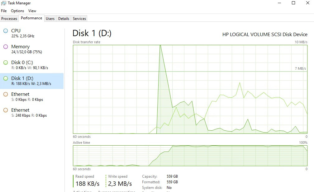

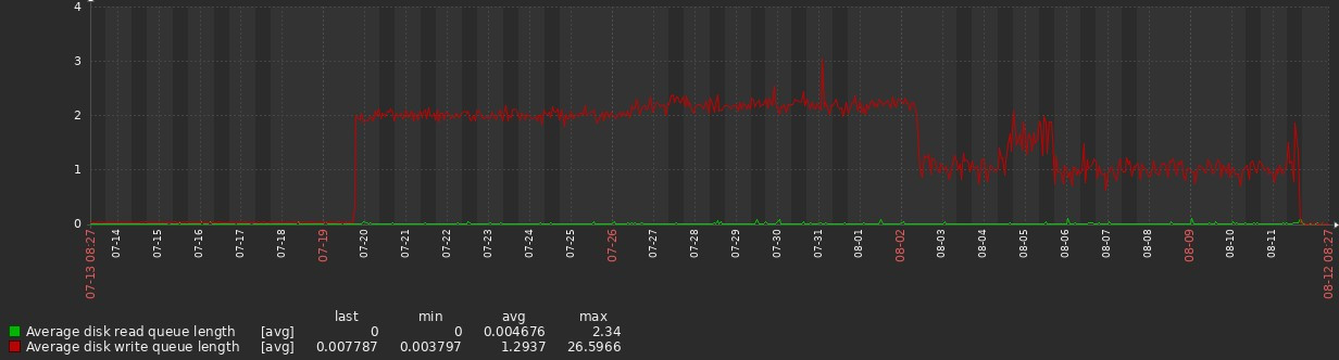

    But when i was on holiday, suddenly on Sunday the 19th of July roughly between 17:00 and 19:00 our server IO Spiked and basically never returned to normal again.
    IO Wait times of 50% or more and that without stopping.
    Stopping the zabbix server, didn't lower it instantly; eventually it would drop. Shutting down MySQL; would stop the IO load.
    Starting the MySQL server didn't start the IO spikes back again and would run normally.
    After starting the zabbix server, the IO spike did return after some time. As far as i could see, the History syncer was busy more then other processes.

    single items stored roughly 3days to max 7days (mostly depending on poll interval); trends stored mostly max 180days;
    i added some screenshots, roughly 24hour graps, Prior to the event, during the event, after the event (with more detail) and after the mysql (+reboot) change.

    Apparently the Raid Accelerator Capacitor died during that time of the event.
    Normally it would just send a warning and you can continue without any real issues.
    I don't know if the reboot or the change of the capacitor did do the trick,
    but after that change the load is back to normal.

        Little overview table usage from phpmyadmin:

              Do you have Zabbix history / trends from before the start of the problem? Graph the disk read and write rates and read and write wait times. If your disk has gone brain dead, the rates may remain relatively unchanged, but the wait times go way up. When raid cache battery dies, a write must be committed to disk before it completes, with the battery, it just has to be committed to the raid RAM, assuming the battery will preserve the data if there is a problem.
              • DrNick
                • Aug 2026
                • 13
                Indeed that is clearly visible in the queue graph, on the Hyper-V host.
                But that also correlates with the 'Task manager' graph from Windows it self, just very high load, relative to the speed it does.
                The weird thing was; that i was able to write read/write full network speed with these disk while coping the entire disk of the vm (~60GB).
                But somehow figured it had to be something with that in the end. Our zabbix installation came from a single WD Blue 7,2k rpm disk with other services
                to an raid 10 with 4x 10k rpm disks and has been running like a sunshine for at least 1,5 year.
                i modified a lot of templates to reduse history and trends, now i can restore them all to store some more data
                Queue:
                Click image for larger version  Name:	zabbix-queue.jpg Views:	0 Size:	68.2 KB ID:	515845
                ReadWrite:
                Click image for larger version  Name:	zabbix-readwrite.jpg Views:	0 Size:	81.4 KB ID:	515846
