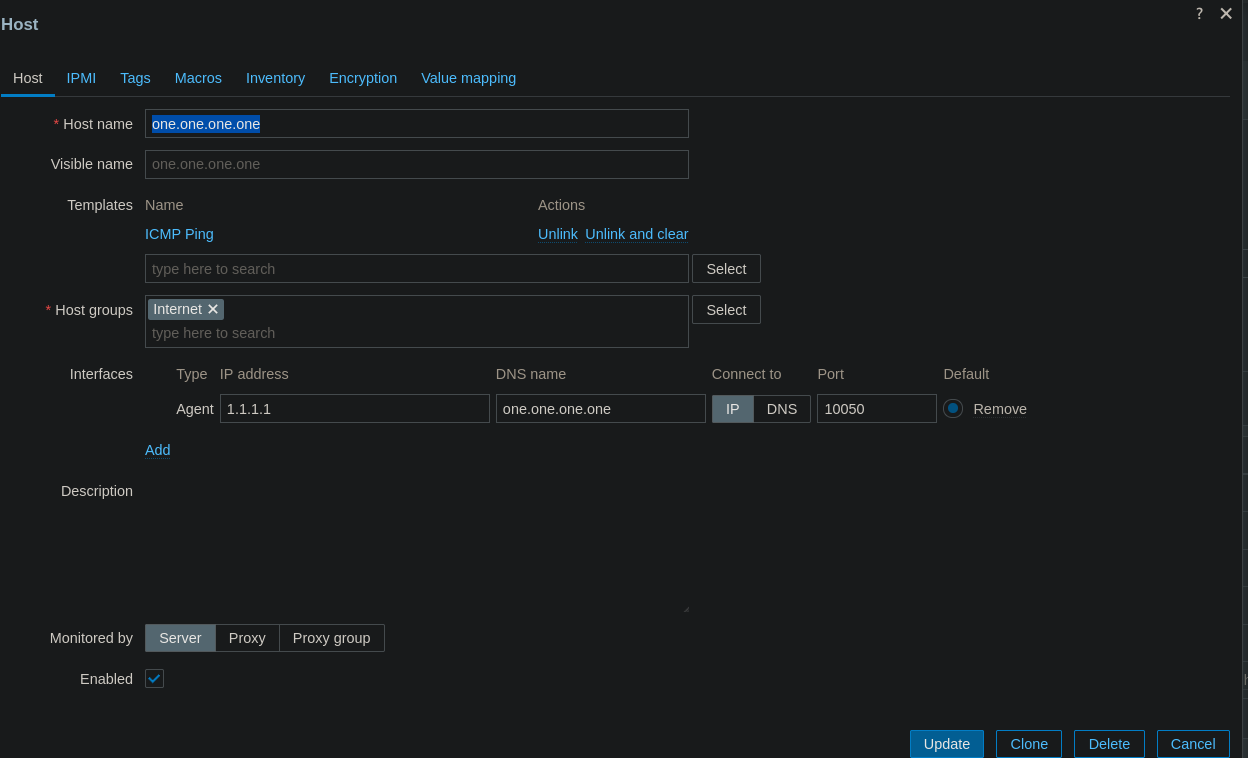

    • MisterGlass
      • Oct 2026
      I'm new to Zabbix and have the same problem. ICMP Ping template doesn't work.
      In a terminal on the Zabbix server I can ping the hosts. And on the Zabbix website running the scripts Ping and Traceroute on the host work just fine.
      Am i doing something wrong?
