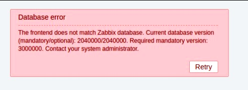

    I had the same problem
    When accessing the web interface, the following error message is displayed:

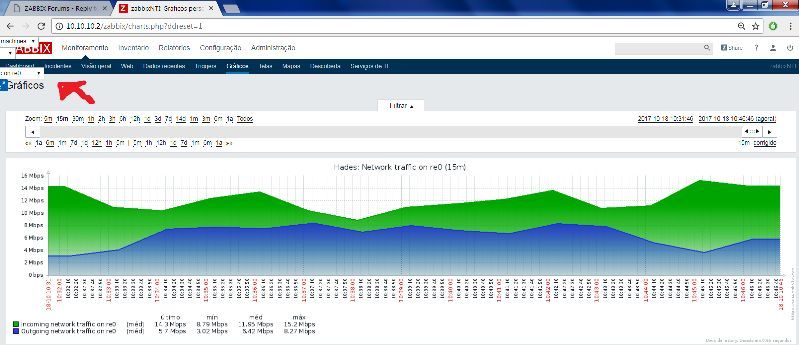

    When accessing again the error does not appear, but a display error occurs in the interface:
    Can anyone help?
    • Atsushi
      • Aug 2013
      • 2028
      Hi denilsongv2,
      The first database error may not have been processed by the database upgrade of the Zabbix server.
      Depending on the version, the database upgrade process may take time.
      You can not access from the new version of the Web frontend until the upgrade process is complete.
      The display may be resolved by clearing the browser's cache.
      • denilsongv2
        • Oct 2017
        Solved problem
        Hi Atsushi,
        Your tip: "The display may be resolved by clearing the browser's cache." it worked out.
        Thank you very much! Restoring backup was becoming the only option
