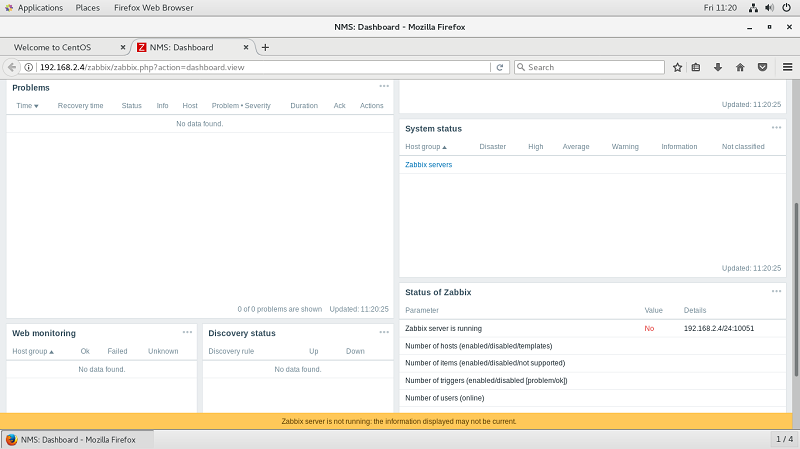

                    still the server is not running zabbix home page is attached

                      Has the zabbix_server process been started?
                      # ps -ef|grep zabbix_server
                      Is something outputted in the log?
                      (/var/log/zabbix/zabbix_server.log)
                      If the zabbix_server process is running, did you set firewalld?
