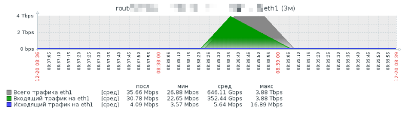

    Sometimes I'm getting unrealistic spikes on graph like this:

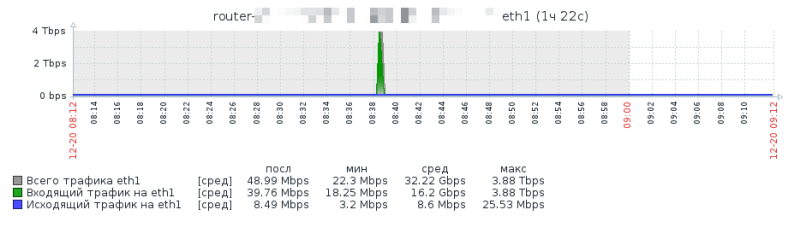

    Which on a zoom looks like this:

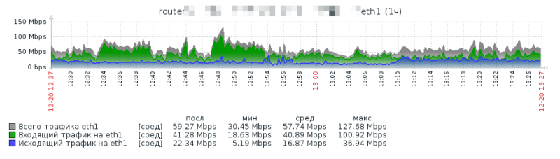

    Other than those spikes rest is graphed normal:
    Checking the database for actual item values during those peaks shows the values of net.if.in/net.if.out are actually quite high sometimes.
    Why does this happens? Some sort of overflow?

      No, the spikes are coming from built-in net.if.in (green on a graph) or net.if.out (blue on a graph). They are just standard LLD items from fresh Zabbix install, I just renamed them in template.
      Calculated item (gray on graph) are actually working as expected. Yes, it's also on spike but that is because underlying net.if.in (green).
