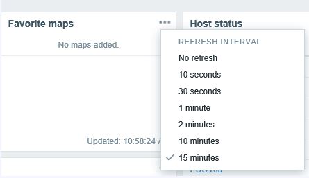

    Good morning.
    After run upgrade from version 3.2 to 3.4, my dashboards favorites (graphs, screens, maps) do not work to add. The "ADD" button does not appear (photo attached), it migrated the ones I had in version 3.2 but the only option I have is to remove.
    All other functions are OK.
    I used SO based on Centos 7.4 only installing with YUM.
    Has anyone had any similar problems or know any way to recover the favorites to normal?

    Please click the 'Edit dashboard' button in the upper right.
