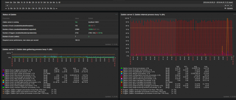

        I updated to ver 3.4.8, on Debian 9.1, esxi 6, HDD 10000 rpm.
        It's work nice for about 1 week, then history syncer busy problem returns I think It's make trigger's recovery dont fire well,
        any advise?

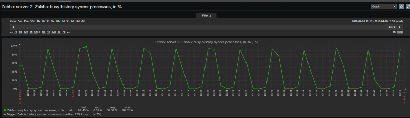

          Closer look
          • kloczek
            • Jun 2006
            • 1771
            #20
            As usually gaps in graphs data are first symptoms of reaching scale of the stack when passive monitoring (which is default) needs to be switched to active one.
            StartPollers=450 With passive monitoring this needs to be increased with NVPS.
            Second thing. If this StartPollers=450 it is from server configuration you need to start adding proxies.
