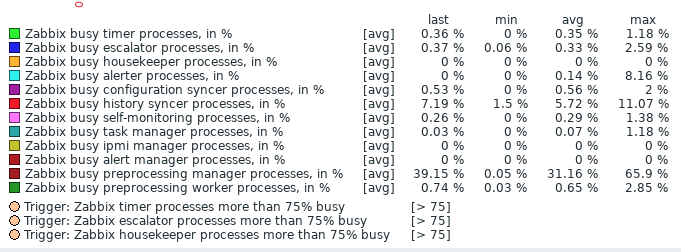

    Included zabbix internal process busy graph. Checked queuesizes, memory swap, etc.
    The only possible problem i see is that the preprocessing process has to much busy % - and the Server specs may be too low.

      But i think i found the problem - after disabling the housekeeping process, i have no more agent unreachable messages. The Screenshot shows the processes during the "problem". I guess the server/database is a way too slow...
      EDIT can't upload the picture, link here: https://ibb.co/kK7vob
