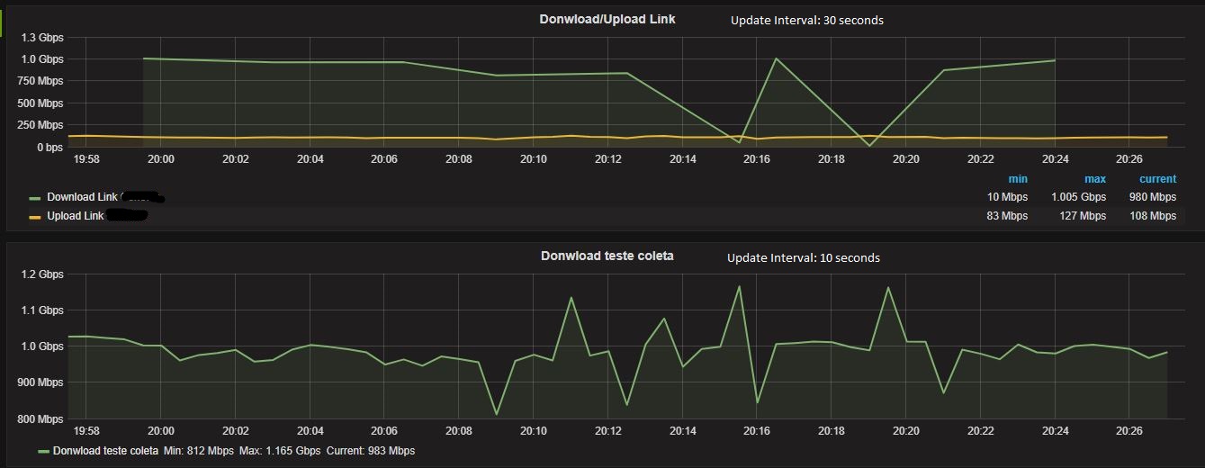

    Helo,Friends.
    I have a problem with the "Update Interval" of the Host Item.
    I want to measure an "Interface Speed - Mbps" from my router. I use "ifInOctets", but my chart does not display the correct value.
    Image attached
    I created two graphs. The first chart with Update Interval equal to 30 seconds, the second chart with Update Interval equal to 10 seconds.
    How should I choose the correct "Update Interval"?
    Do I need to figure something out? This site says that it is necessary to make calculations with the value received by ifInOctets.
    Thankkss!!

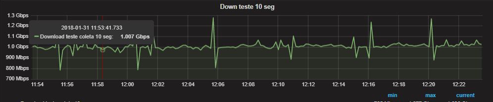

    Print
    Print. It's not normal

      Use the 64 bit counters -- ifHCInOctets and similar
