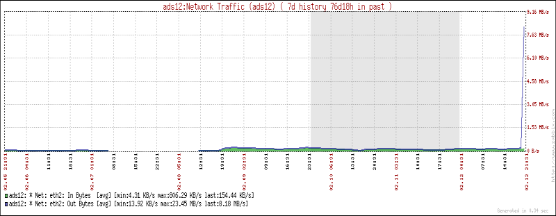

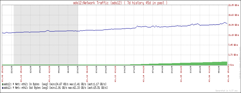

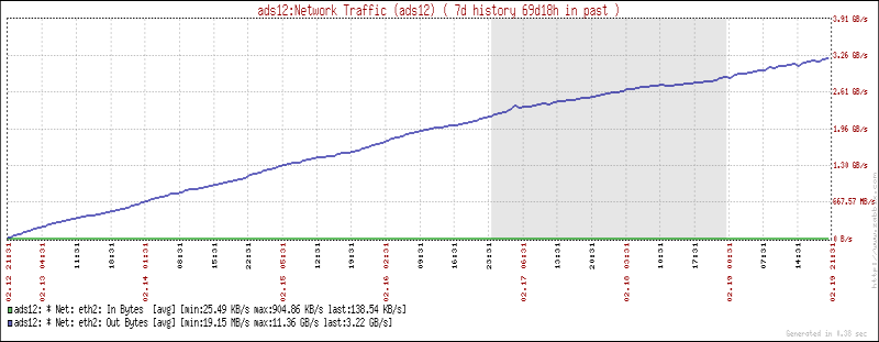

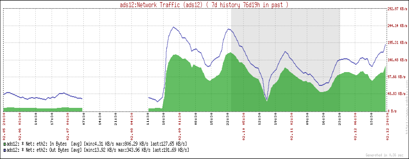

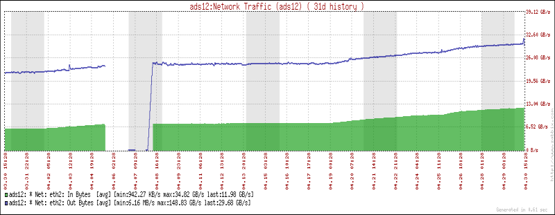

    Chart 2c shows the weekly traffic graphs just before the problem appeared
    Chart 2d is from an hour later when the problem occurs on the outgoing traffic
    Chart 2e is from a week later - you can see the network traffic showing obviously bad values (if only my network card got faster the longer I used it!)
    Chart 2b shows when the problem when it started occurring on the ingoing traffic
    Finally, Chart 2a shows the last month of traffic with my outgoing traffic being listed as almost 30GB/s
