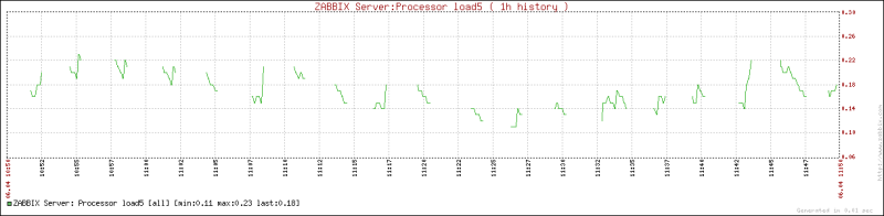

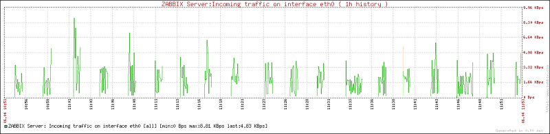

    I finaly managed to install the new zabbix.1.4 on an ubuntu 7.04 server (vmware) and got everything to work. Considering I'm a Windows man, this was quite a task, having to compile stuff, etc.
    But now my graphs are not working correctly. For some weird reason the lines are interrupted... Please see the attached pictures.
    Anybody have a clue? Is this due to vmware?
    Any help would be appreciated!

    The lines are broken because there is missing data. This usually happens when the zabbix_server process is stopped or the agent is not reachable (i.e. network issue or zabbix_agent is off).
