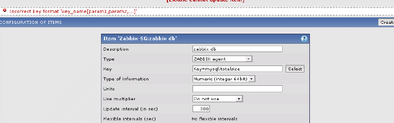

    • BusteR81
      • Apr 2007
      • 150
      Originally posted by shrinivas.bura
      1.4.1 zabbix
      tried Key=mysql.totalsize
      tried key=mysql.totalsize
      Key=[mysql.totalsize]
      key=[mysql.totalsize]
      key[mysql.totalsize] can 'save' but returns Not supported
      However none works
      cheers
      • jmb
        • Jul 2007
        • 14
        Remove the 'Key=' from the Key field.
        Greets jm
