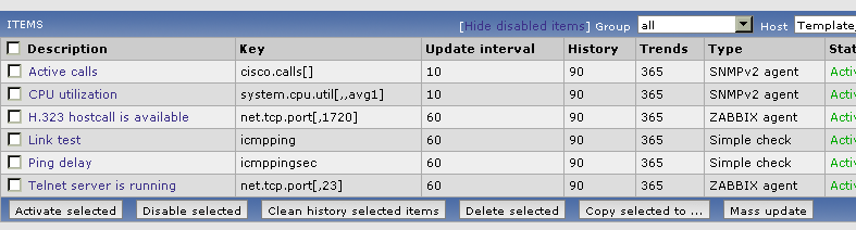

I'm new to Zabbix, currently using nagios+mrtg but wish to migrate to all-in-one solution (like zabbix is). My net is mostly of cisco/SNMP agents, and I can't get some things work right. First, I created some templates (for dialup access servers, for voip gateways, routers and switches). I'm able to get some snmp data of my interest (I don't need all of the SNMPv2 template so I created my own from scratch). But I'm stuck with basic things like telnet/ssh/h323hostcall tcp ports check. One of my templates is set as shown on screenshot attached. This template is used by several gateways with identical HW/SW configuration. but I get constant errors in log saying that:
These errors repeat for each gateway configured with this template, only hostnames and IPs differ in log. Zabbix server is binded on 192.168.12.8, my ACLs on gateways have no restrictions, and I can manually telnet to that ports (1720 and 23) from the zabbix-server shell.
Whenever I try to switch from "ZABBIX agent"+net.tcp.port[] to "Simple check"+tcp,port - I get error "Incorrect key format 'key_name[param1,param2,...]'". If I change key to tcp[23], I can save item, but within the exact host this item shown as "Not supported".
1365:20070807:081356 Host [gw05.xxx.xxx]: first network error, wait for 15 seconds 1365:20070807:081356 Parameter [net.tcp.port[,23]] will be checked after 240 seconds on host [gw05.xxx.xxx] 1359:20070807:081356 Get value from agent failed. Error: Cannot connect to [192.168.12.5:0] [Connection refused] 1363:20070807:081416 Host [gw05.xxx.xxx]: first network error, wait for 15 seconds 1363:20070807:081416 Parameter [net.tcp.port[,1720]] will be checked after 240 seconds on host [gw05.xxx.xxx] 1361:20070807:081416 Get value from agent failed. Error: Cannot connect to [192.168.12.5:0] [Connection refused]
