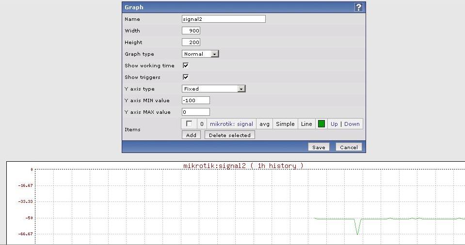

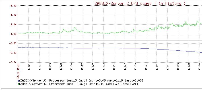

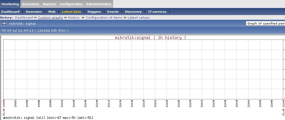

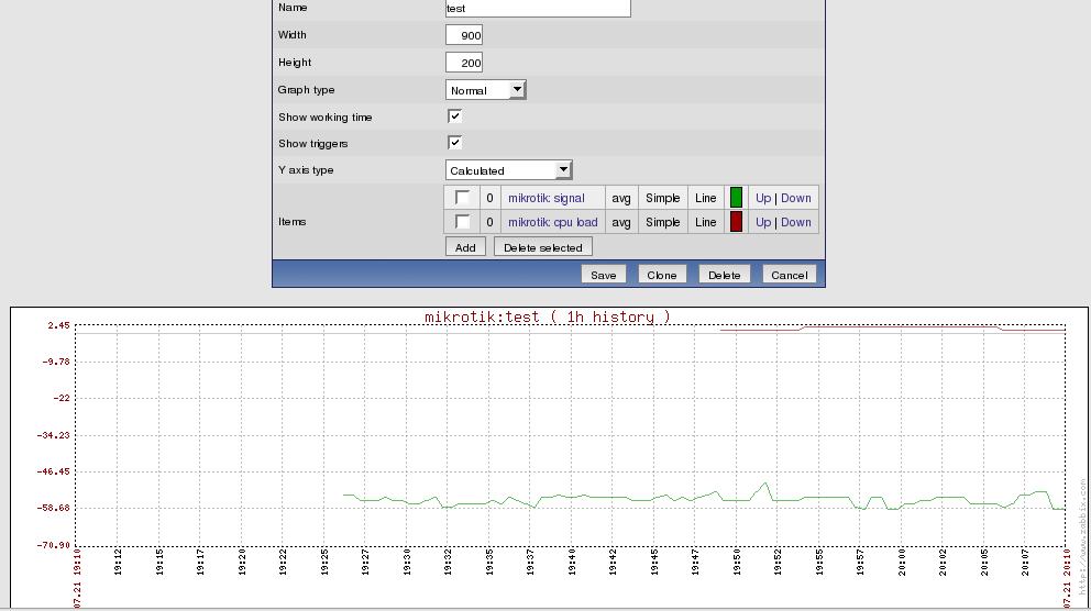

The good news - negative numbers are now supported.
The bad news - default graphs don't seem to like them, as the graph y-axis ignores negative numbers, making them much less useful.
Any suggestions on where to look to make the graphs use a meaningful set of default values for the y axis.

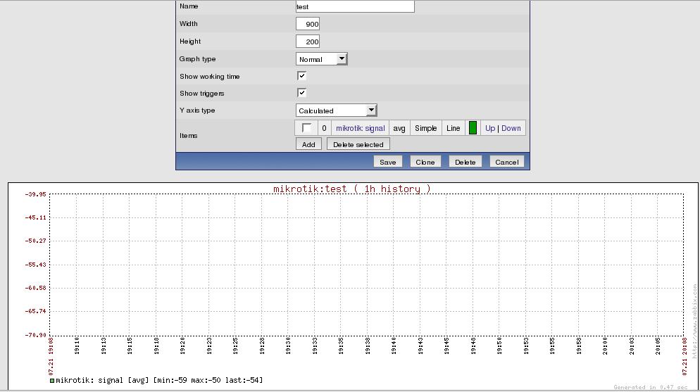

***UPDATE***
It's the functions calculateMinY and calculateMaxY in graph.inc.php, but my math is weak, the code is not commented, and there is a lot of mantissa and exponent manipulation. A patch here would be very helpful!
Also, in the code, chart3.php, lines 46 and 47 are duplicates, one should be removed (yaxismax is duplicated).
***UPDATE***
