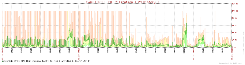

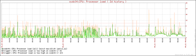

    I have been chasing some very strange "network" issues in the last couple of weeks. One of the things I found was that a couple of my slow\overloaded servers were considerably worse in the last couple of weeks than they have been in the past. I finally narrowed it down to zabbix event log monitoring in 1.4.2. Up until 3 weeks ago I was using version 1.1.6 of the agent and never really had any issues with it.
    Attached is a graph of cpu load and util showing a 48 hour time span. I stopped monitoring the event logs at about 9:30 AM yesterday (which is just about the center of each graph) and you can clearly see a massive drop in the number of cpu load and utilization spikes. I saw the same results on three other servers that I tested this on. This only seems to be an issue with servers that are CPU bound (i.e. they don't have enough cpu power available) but you can see a "spike" in activity on all servers that do event log monitoring.
    Anyone else see this? Were there any changes to event log processing that hurt the performance that badly?
