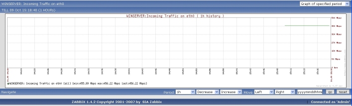

As someone that has come from using Nagios, BigBrother and Hyperic I am very excited about what Zabbix might bring to the table. I have been evaluating various new solutions and would love to settle on one to promote and even contribute to. It seems that windows support is a little weak at this point and I cant seem to get any windows servers network interface monitoring. The lack of a pre-configured item for Windows nics (and many other services) is really disapointing. Anyway, I tried to follow some instructions on a forum post to get the nic monitored and I followed the steps below.....but not getting any data?
