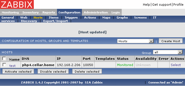

    2.2) The zabbix configuration of the host "php4.cellar.home" in the frontend reports Availability "Unknown"
    See attached image "zabbix-config-host1"

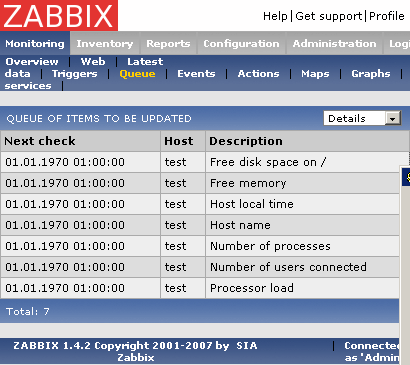

    2.3) The queue details view in the front end says:
    see attached image "zabbix-queue-details1"

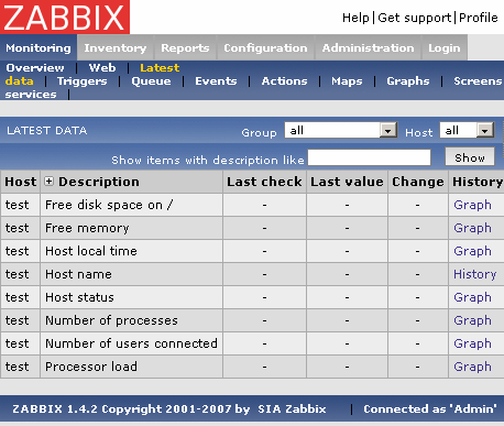

    2.4) The latest view under monitoring says (01.01.1970 01:00:00 I'm puzzled??):
    see attached image "zabbix-latestdata1"

          Enabling the agent on the server doesn't make any difference. No data comming in either. I've already compiled, installed and configured Zabbix 1.4.1. But I've the same problem here.
          Could it have something to do with this 1970 date issue in the queue?

              Your screen shot of the host setup shows that you haven't selected a template for that host. You need to select a template, in your case Template_Linux template, otherwise you wont get any data as the agent doesn't know what metrics it should be monitoring.
              Jon

                • 63

                  The problem is solved!
                  If you read my zabbix_server.conf file at point 4.5 in thread post "23-10-2007 12:29" it says "NodeID=1".
                  I need to make it "NodeID=0" to be able to retreive data. Yipeeeee!!!!!
                  Solved it myself.

                    I see that your zabbix_server has NodeID=1.
                    Did you upgrade your database to "distributed monitoring mode" (zabbix_server --new-nodeid 1) ?
                    What if you create simplechecks (ping) instead of zabbix_agent items ?
                    Edit: you made the same mistake as I did ("Yeah let's define a NodeId despite this is a standalone server" )

                      No I did't upgrade the database to "distributed monitoring mode". I just started with the so simple installation instructions and overlooked the fact that the NodeID needed to be set to 0 for a standalone server. But than again, this is easy overlooked because the remarks in the server configuration file says:
                      # This defines unique NodeID in distributed setup,
                      # Default value 0 (standalone server)
                      # This parameter must be between 0 and 999
                      And furthermore the standalone option isn't explained in the manual, so it was searching for a needle in a haystack if you ask me.

                        I've wasted 2 days on this too.
                        Running zabbix_server in debug mode and then finding out in the code where that "host_id" condition came from, in the sql queries.
