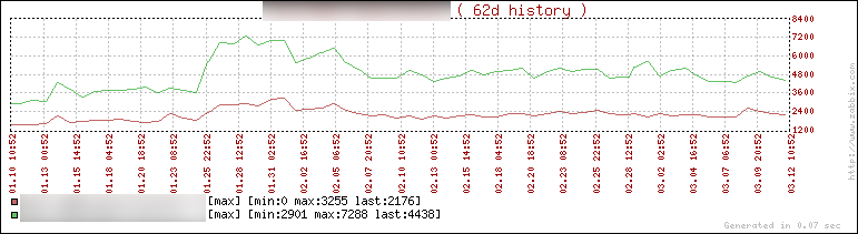

    Got an odd issue with some graphs of low frequency data. This issue cropped up only since I upgraded from 1.1.2 to 1.4.4, but is affecting items that existed before the upgrade and new ones created since.
    It seems that periods beyond 34 days render perfectly well, as do periods below around 24 hours. Anything in between results in blank graphs in some cases, or as in this example big gaps in the lines.
    Example graphs with 2 items, both with frequency 86400 seconds (1 day) First one, 31d, broken. 2nd one 62 day, working. The data and trends seem to be intact in both cases.
    Any ideas what might be causing this (or how I could debug it further? There's nothing useful in the logs)

    Attaching the second graph separately to avoid it stretching the post to an enormous width.
    Terry.
