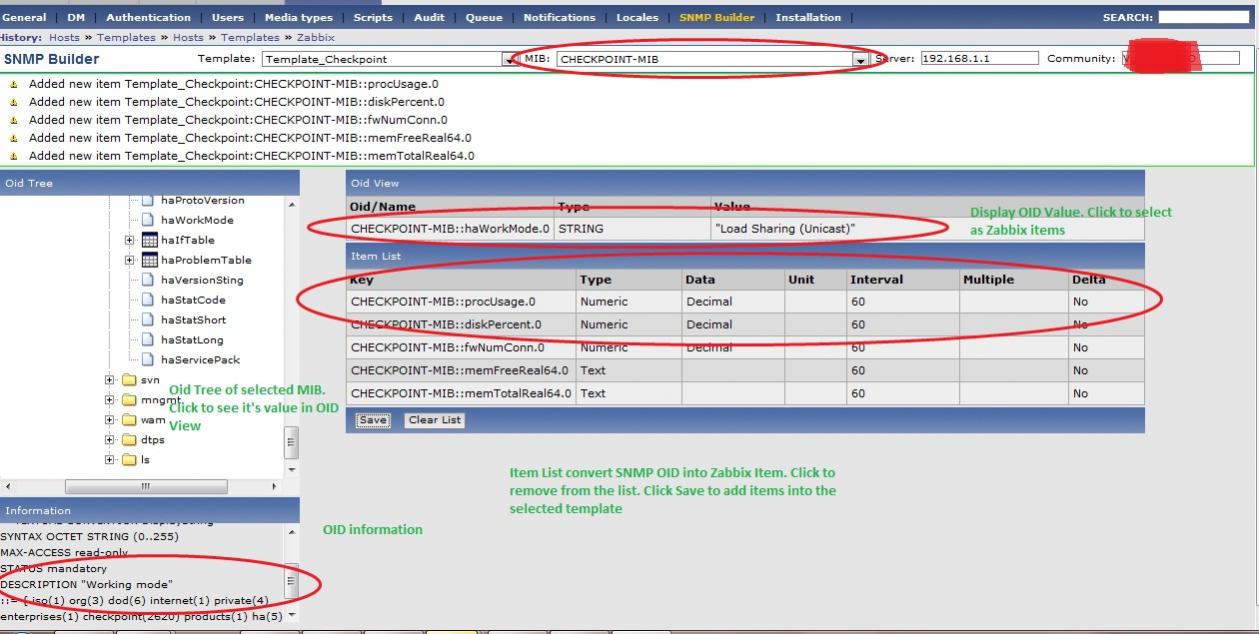

I'm working on a snmp builder tool to browse, convert and insert snmp oid into a template. It still some minor bugs. I will post it soon. Here some of screenshots and features.

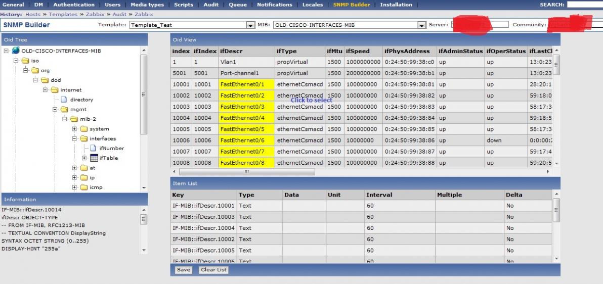

Support snmp table

Here you are
http://yangho.byethost22.com/wiki/do...g:snmp_builder
Features:
  • MIB Browser: you can select default MIB files or your own device MIBs to get OID tree. Click on the tree to retrieve value and information about a OID. Click to select the OID as Zabbix's item.
  • OID Table support: it assume that a OID whose name's end with string 'Table' is a OID Table. OID Table will retrieve with all it's indexes. Click on the cell to select the index as Zabbix's item. If my above assumption is wrong, you can use the checkbox “view as table” to switch between table and normal view.
  • Column selection: On OID Table, click on a header will select a whole column as Zabbix's items. It's useful if you create SNMP template for a 48 ports switch.
  • Auto convert: I implement a simple convert from SNMP Type to Zabbix's item.
If u got any bugs, please post here.

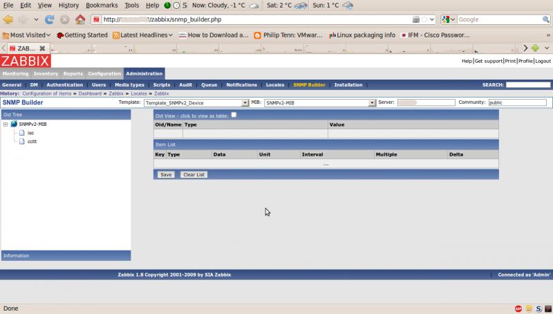

giapnguyen,
Great work! It's one of most awaiting features I've wished to see. But I have small problem: can't browse MIB tree. After selecting MIB from drop-down list I have the following in the left sub-window.

Hi Firm
Yeah, my code heavily rely on snmp OS commands. I work on Ubuntu 9.10 and still not sure the output is same in other *nix. So please tell what OS, you install zabbix and try to run from OS prompt
snmptranslate -Ts -M <your MIBS_ALL_PATH> -m SNMPv2-MIB
Give me the output, and I will know why it don't render the oid tree

giapnguyen,
CentOS 5.3 x86. The output is attached.

Quote:
Originally Posted by Firm View Post
giapnguyen,
Your output is fine. It's same with mine. I narrow down your problem to (1) snmptranslate not in search directory of apache's user, so it can't lauch the command; (2) there is a permission problem prevent snmptranslate run from php script (maybe because of selinux, apparmor, php.ini ...)
I glad to use php's snmp api to avoid OS-dependent problems but unfortunately it don't have sufficient features. I will install a CentOS 5.3 to check it.
You can try create a test.php in zabbix web dir contains:
PHP Code:
<?php
    exec
("snmptranslate -Ts -M /usr/share/snmp/mibs -m SNMPv2-MIB 2>&1"$results);
print_r($results);
Browse the test.php to see what happen when run snmptranslate from web.
