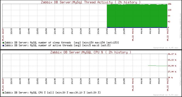

            One thing that i still don't know how to due is tuning down the CPU consumption of mysql. All the tuning above helped, but i'm still primarily cpu-bound on zabbix, and I don't know what mysql is spending all its time doing. I've upgraded the server above to a dual-quad, but then threw more stuff on it, and now its pretty well saturating all the CPUs again. I upgraded mysql to the latest 5.0.x and it didn't make a lot of difference -- I haven't gotten around to testing 5.1.x or any dev versions yet.
            I still just don't know how to tell what is spending all the time in the CPU, and what requests might be CPU-heavy... Since it is a database, ideally I'd like it to look a bit more IO-bound...

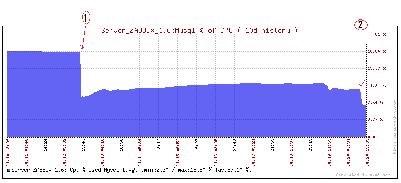

                            First, thanks for sharing your mysql tuning experience, it has been a huge help!

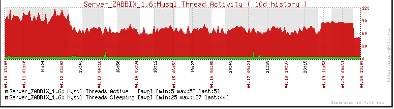

                            Second, regarding CPU consumption of mysql. Up until a week ago, mysql on my zabbix server had always stayed pretty constant at around 18% - 19% of cpu. Now I have it down to 7%! Look at the graph below:
                            How this came about was that I had often wondered what would be the optimum number of StartPollers and StartTrappers. Too few Pollers/Trappers is not good, and too many is also not good. So how does one know where that 'happy medium' is. I created the following UserParameters, and created a 'stacked' graph. The graph clearly showed that most of my mysql threads were spending their day Sleeping (using up resources).
                            UserParameter=mysql.threads.sleep,mysqladmin -u admin -padmin processlist | grep Sleep | wc -l
                            UserParameter=mysql.threads.active,mysqladmin -u admin -padmin processlist | grep -v Sleep | wc -l
                            [Sorry, having trouble placing the graphs in the desired place. So they are both at the bottom. You'll see, one is 'mysql threads', the other 'mysql cpu'].
                            On the graph below, at point #1 I reduced both Pollers and Trappers from 50 to 30. The difference is obvious. And I still have plenty of sleeping mysql threads.
                            At point #2 (today) I reduced them further, from 30 down to 15. And still plenty of mysql threads to carry the workload. Oh, and nothing in the queue!
                            The graph shown below is from this UserParameter:
                            UserParameter=mysqld_cpu.pc,ps auxw|grep mysqld|grep -v grep| awk '{s+=$3} END {print s}'
                            I would appreciate any feedback. Try it and see if it helps.
                            MrKen

                              With that said... on my Zabbix server I have:
                              StartPollers=5
                              StartTrappers=128
                              I know trappers is high, but it was set that way for our anticipated load of 12 globally located proxy servers handling 2,000 hosts. Currently we are only at 200 hosts. We will hit the 2,000 mark shortly after our 1.8.2 upgrade.
                              Just started collecting, but here's what I am seeing so far:
