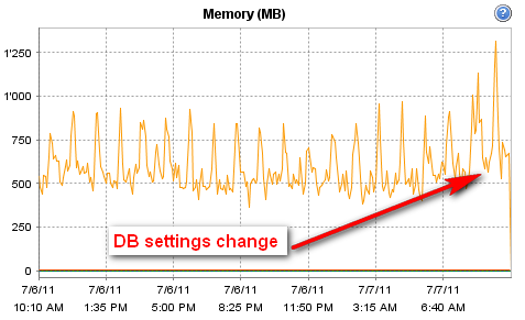

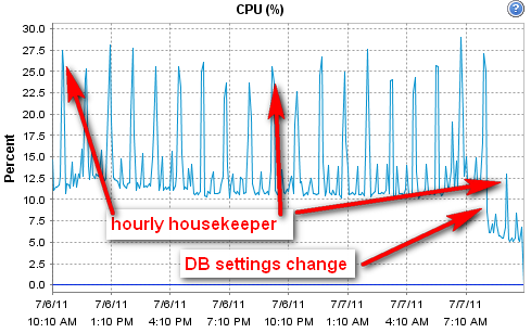

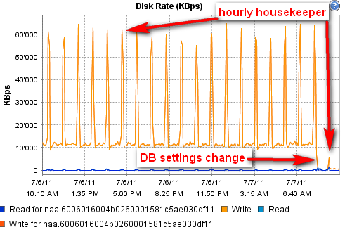

          I'm runing Zabbix 1.8.4 on SLES 10 virtual machine (2vCPU, 4GB RAM), DB is 40GB (340 hosts, 12k items). Required server performance, new values per second: 183.66.
          I have changed the following settings: in () old values or defaults:
          innodb_buffer_pool_size = 3G (16M)
          innodb_log_file_size = 64M (5M)
          innodb_flush_method=O_DIRECT
          innodb_flush_log_at_trx_commit=2 (1)
          tmp_table_size=256M (32M)
          max_heap_table_size=256M (16M)
          table_cache=256 (64)
          Does it really improve performance ? YES (and reduce a lot I/O and MBs on disks)
          Have a look on pictures:
          CPU "2011-07-07_141032.png",
          Memory "2011-07-07_141312.png",
          Disks I/O "2011-07-07_141607.png"
          My storage admin is very happy now !
