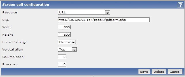

                        Hi guys,
                        I installed it but maybe I don't understand how to use it.
                        Once I finished follow "how to" instruction, how can I get back pdf report
                        starting from my custom graphs ?
                        Looking to screens I see the first written into procedure, it appears like a pdf with header footer and date but no graphs inside, and second one with no data inside.
                        What is missing ? Where can I find "generate" button ?
                        Many thanks
                        F.
                        • Axilla
                          • Aug 2010
                          • 130
                          #27
                          Originally posted by zabbixflic
                          Hi guys,
                          Many thanks
                          F.
                          you're adding the wrong page to your screen it sounds like.. you should add pdfform.php to your screen.. NOT pdf.php
                          • zabbixflic
                            • Jan 2012
                            • 39
                            #28
                            Now, loading screen in monitoring or configuration view I see a blank page.

                            • Axilla
                              • Aug 2010
                              • 130
                              #29
                              f.
                              does the user in your config.inc.php have proper API access? Turn on error_reporting and see what you see if not. Paste here, we'll get it working.
