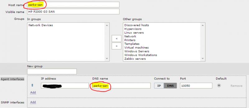

                            • crispytown
                              • Feb 2015
                              #74
                              I had the same issues with the files being created but not importing the data.
                              info from server: "processed: 0; failed: 55; total: 55; seconds spent: 0.000757"
                              sent: 55; skipped: 0; total: 55
                              What I did to get it to work was make sure in the configuration for the host... that the "Host Name" is the spelled the same as the Agent interfaces "DNS Name". See Capture.jpg
                              • adambmedent
                                • Jun 2012
                                • 22
                                #75
                                I gave it a shot but I still just get a value of 0.
