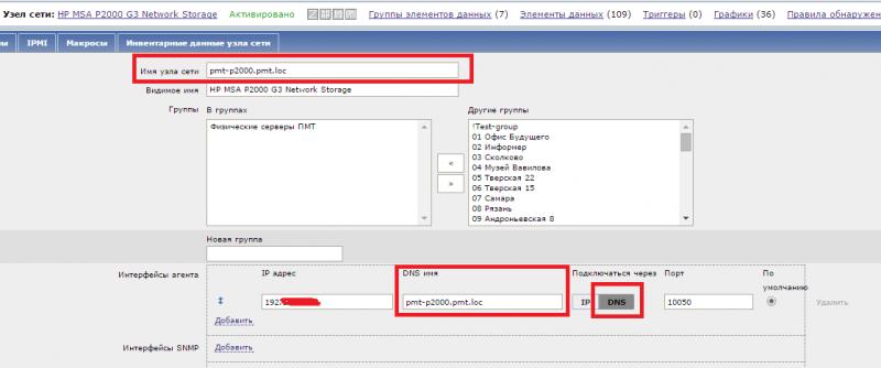

      Originally posted by crispytown
      I had the same issues with the files being created but not importing the data.
      info from server: "processed: 0; failed: 55; total: 55; seconds spent: 0.000757"
      sent: 55; skipped: 0; total: 55
      What I did to get it to work was make sure in the configuration for the host... that the "Host Name" is the spelled the same as the Agent interfaces "DNS Name". See Capture.jpg
      Hello, Crispytown!
      Unfourtunatly, your solution didn't take effect for me. I still have "0", when I run script. And if I try start manually Zabbix_sender:
      PHP Code:
      zabbix_sender -c /etc/zabbix/zabbix_agentd.conf -i /var/tmp/zabbixSenderHPP2000_pmt-p2000.pmt.loc_30085
      I have the same error:
      PHP Code:
      info from server: "processed: 0; failed: 55; total: 55; seconds spent: 0.001006"

                          1) Chek Hostname (case sensitive) MSA P2000 in zabbix server and in file zabbixSenderHPP2000_HOSTNAME_15863. Add MSA P2000 in /etc/hosts with correct name.
                          2) Check that the LLD works, and this items (from file zabbixSenderHPP2000_HOSTNAME_15863) exists in zabbix.
