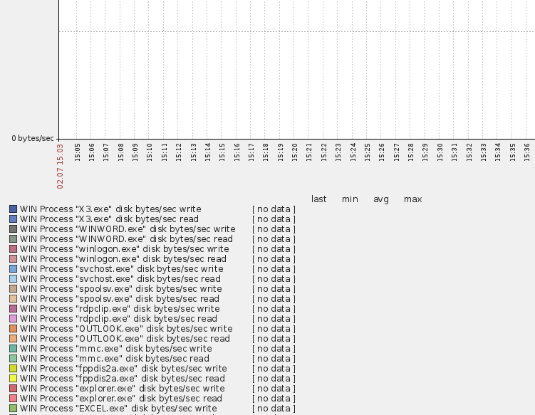

In a real world scenario you end up with these types of graphs:
