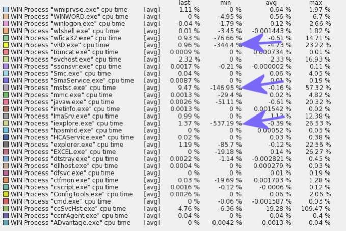

                  #53
                  Is anyone else observing negative amounts on the processor time stack graph? Any way to correct this?
