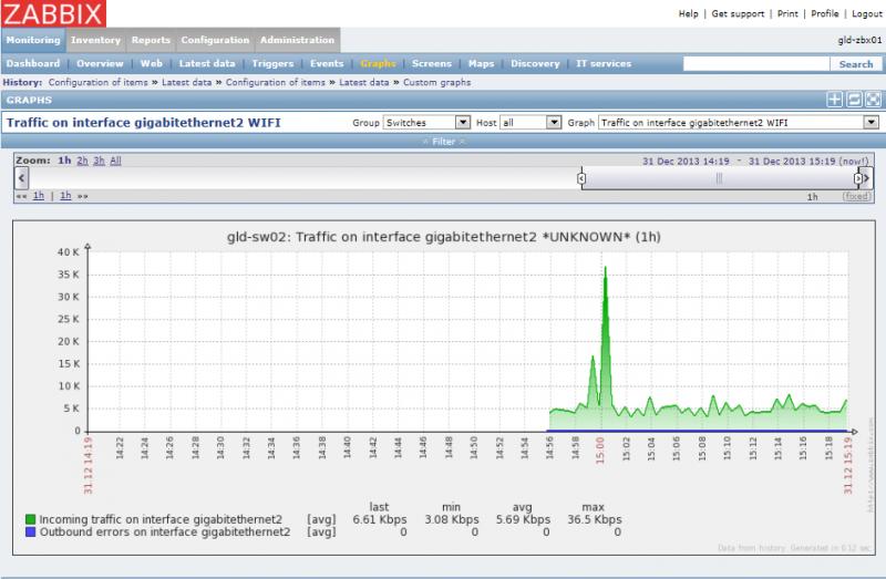

    I'm creating a template for a switch using a discovery rule via SNMP. When I create the prototype graph I use {{HOST.HOST}:ifAlias[{#SNMPINDEX}].last(0)} in the graph name. What I read everywhere is that this is possible but at my zabbix installation it is not working. In the graph name all my graphs are stated with *UNKNOWN* (see screenshot)
    I'm running zabbix 2.2.1 on a centos server. Does anybody have an idea where to start to look to fix this problem?

      wasn't sure wich one you want to see actualy but hopefully this is what you need.

          you are right, I have tested it earlier with {#SNMPVALUE} but I forgot to revert it back. Now I have reverted it back to what it should be and now it is partly working, in the drop down menu the correct name is displayed but in the graph name itself is still stated *UNKOWN*

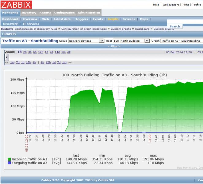

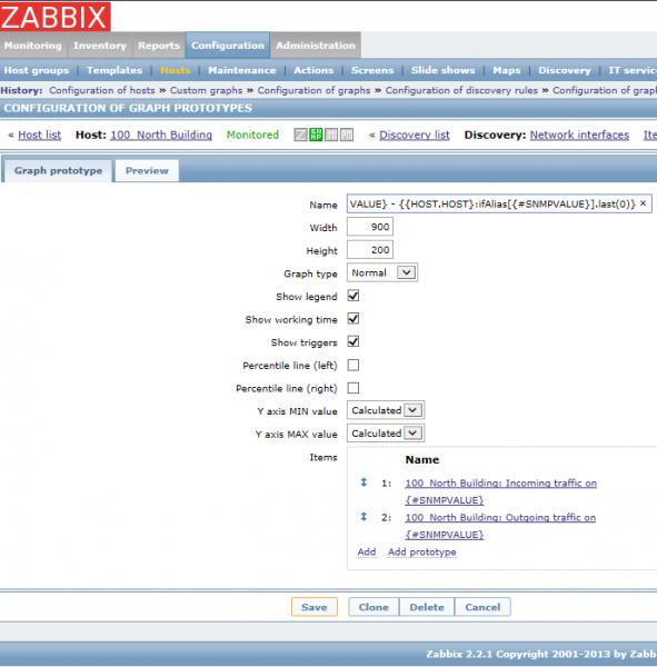

                      Name: Traffic on {#SNMPVALUE} - {{HOST.HOST}:ifAlias[{#SNMPVALUE}].last(0)}
                      Sincerely yours,
                      Aleksey

                          I gave you my Graph prototype name and Graph which was created from prototype.
