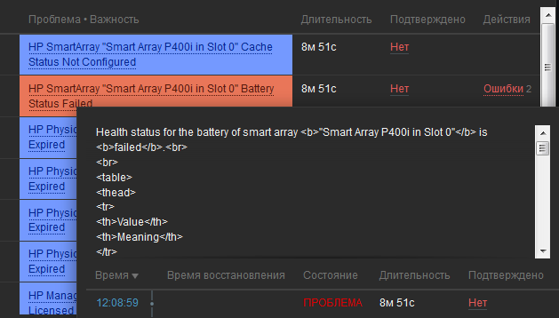

              Tell me this is normal when my trigger is triggered and if I click on the “Problem” with a mouse, then a pop-up window opens with a description and is there text with HTML tags?

                Hi, I have the same result on different web browser, but I'm not worried for it The trigger works, this is the important thing
                But if DeltaCentral resolve it, he's welcome!
