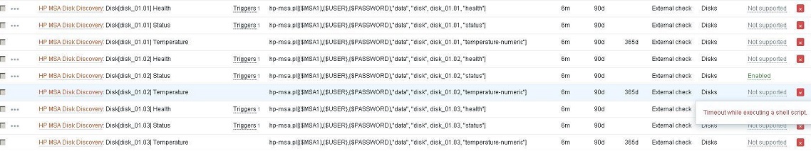

                          in server logs there are many time limits when script is executed.
                          I set value Timeout=30 in zabbix_server.conf

                            that is a good hint. i raised my timeouts to 20 sek
                            • varnav
                              • Jul 2009
                              • 36
                              #29
                              Anyway MSA2040 doesn't seem to be able to handle many queries at once. I've tried to balance queries between 2 contollers but that did not help.
                              HPE support is not willing to help with this.

                                Server logs:

                                3171:20160401:084755.175 item "HP MSA 2040 B:hp-msa.pl[{$MSA1},{$USER},{$PASSWORD},"data", "vdisk", dgA05, "status"]" became supported
                                3173:20160401:084756.282 item "HP MSA 2040 W:hp-msa.pl[{$MSA1},{$USER},{$PASSWORD},"data", "disk", disk_02.18, "status"]" became not supported: Timeout while executing a shell script.
                                3174:20160401:084758.191 item "HP MSA 2040 B:hp-msa.pl[{$MSA1},{$USER},{$PASSWORD},"data", "enclosure", 1, "enclosure-power"]" became supported
                                3173:20160401:084758.347 item "HP MSA 2040 B:hp-msa.pl[{$MSA1},{$USER},{$PASSWORD},"data", "enclosure", 2, "health"]" became supported
                                OK, how can I solve this problem?
