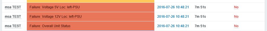

        I have a problem with my zabbix 3.0 (CentOS 7). "Value should be a JSON object" what is the reason?
        json answer:
           "data" : [
                 "{#KEY}" : "A",
                 "{#CLASS}" : "Controller"
                 "{#KEY}" : "B",

          the Manual execution of the script produces the json Output? can you check the Output with the zabbix Client
          /usr/local/sbin/zabbix_get -s127.0.01 -p10050 -k<KEY>
          • remmal

            here is the output of this command:
               "data" : []

              Timeout while executing a shell script.
              this can be fixed by rasising the max execution time on the Agent!
              Please check your configs:
              ### Option: Timeout
              #       Specifies how long we wait for agent, SNMP device or external check (in seconds).
              # Mandatory: no
              # Range: 1-30
              # Default: 3
              Timeout=10
              i recommend 25 seks.
              Other idea i am working on:
              SNMP template.
              It is not possible to Monitor specific HDDs or Temperatur. But u can Monitor Hardware failure. please find attached the template.
              I am still working on it, but it should work.

                That's not the problem. Zabbix is already Timeout=30 seconds
                ### Option: Timeout
                #	Spend no more than Timeout seconds on processing
                # Mandatory: no
                # Range: 1-30
                # Default:
                # Timeout=3
                Timeout=30
                • michael.weber
                  • Nov 2015
                  • 121
                  #53
                  kann you try to delete the host and readd it.. at the Moment i dont have any other idea.
