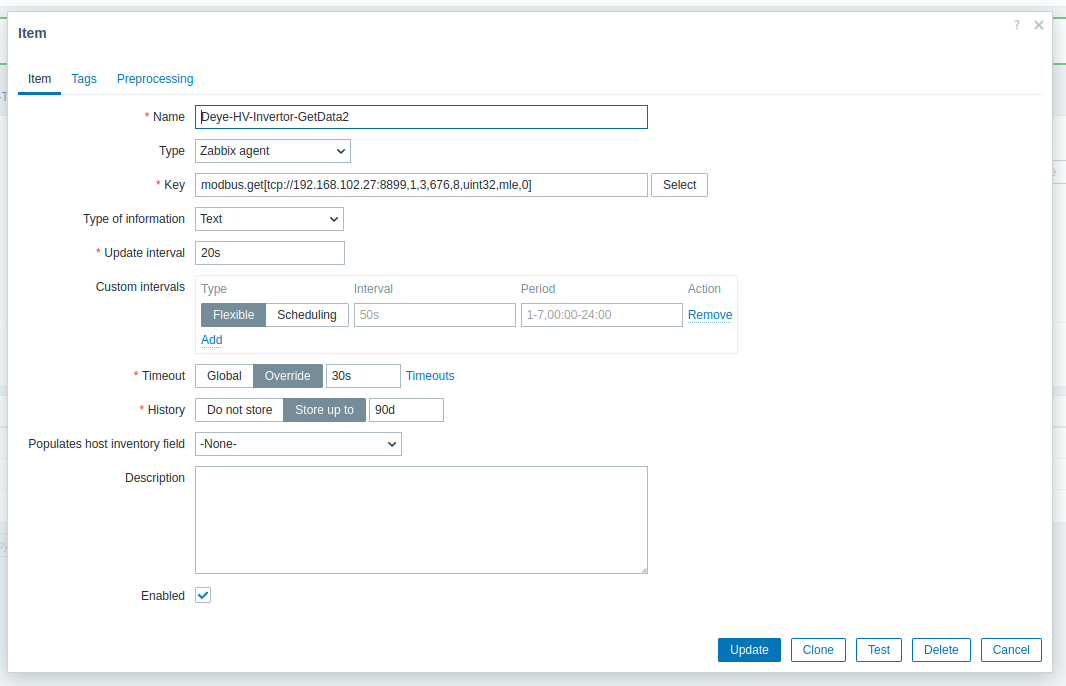

    hello, in a neighboring thread I was told how to read registers via modbus as an standard zabbix modbus get,
    would like to make a proper template now and share with the community
    sun30k is a high voltage inverter,
    sun6k is a low voltage inverter,
    so, patterns will differ due to differences in internal registers
    It is interesting to know how many registers can be read at a time, is it limited by software or does it depend only on the device?
    for example, now I'm trying to implement it like this
    one main Item, which will receive 10-20 values ​and give to subordinates
    Click image for larger version  Name:	image.png Views:	0 Size:	58.1 KB ID:	494436​
    is this the correct implementation?

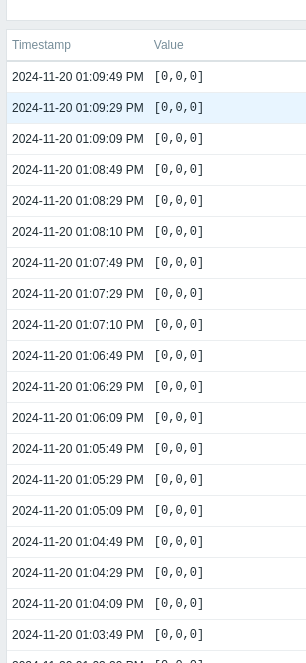

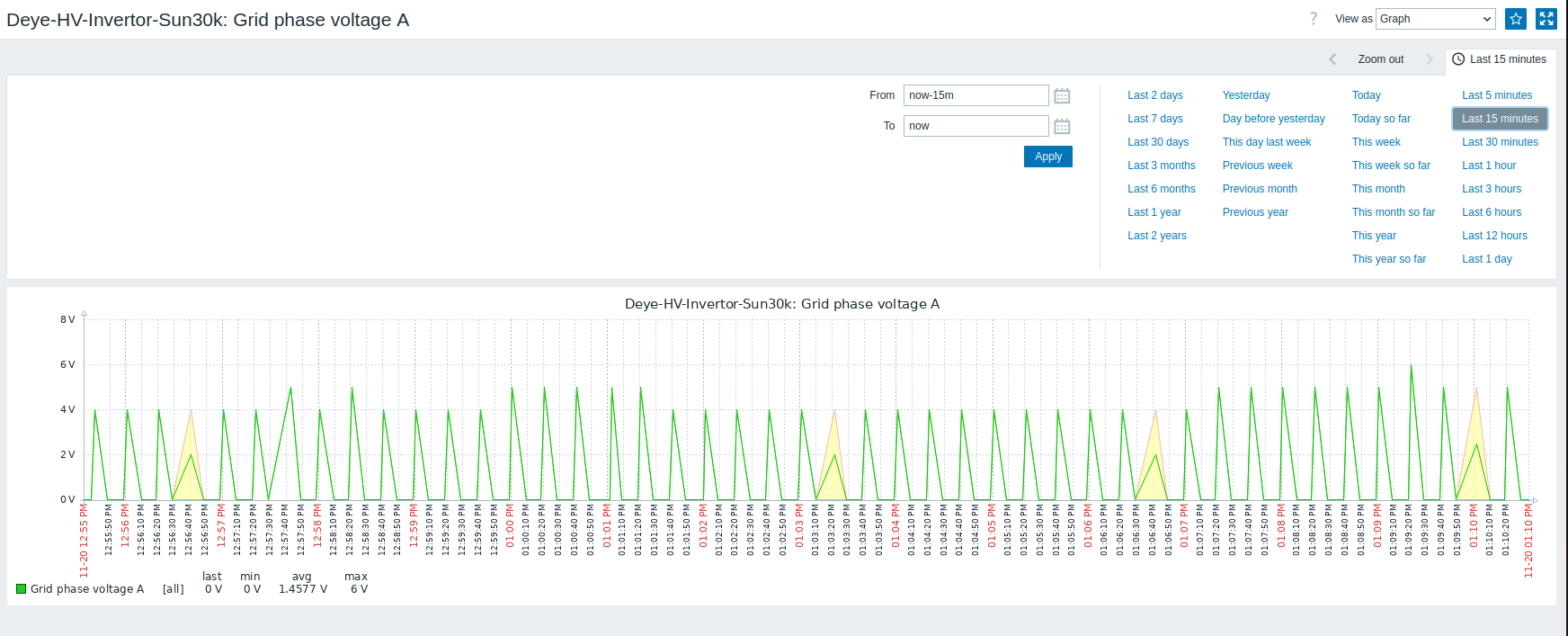

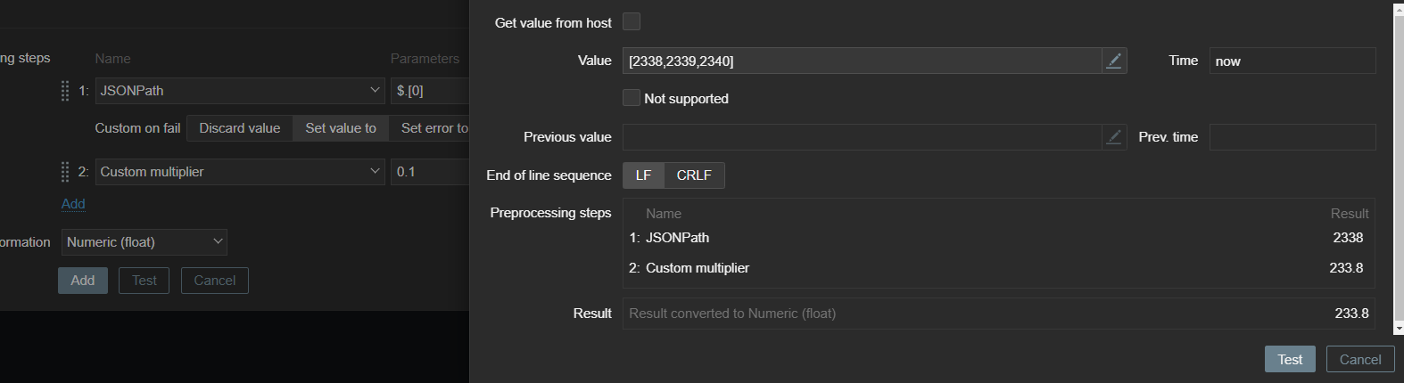

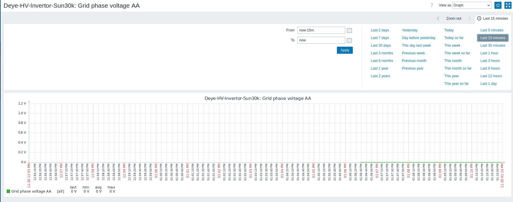

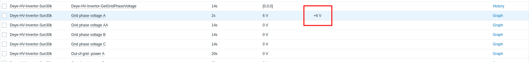

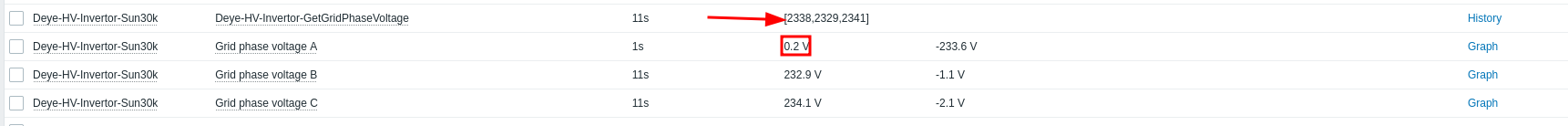

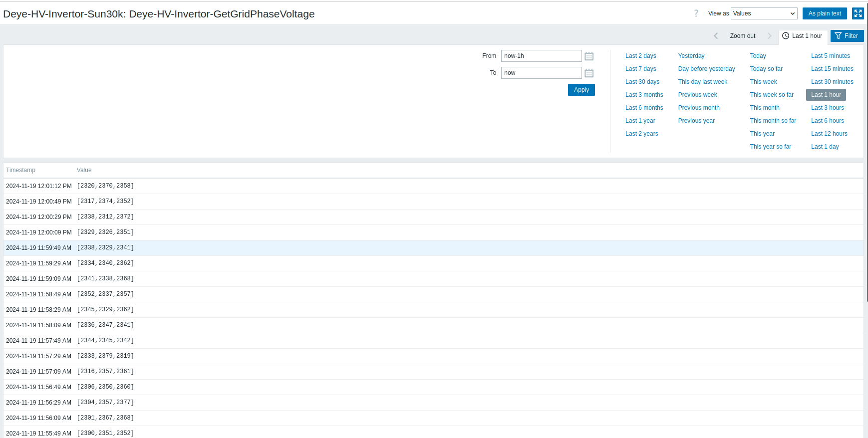

    Yesterday I created an item with a key that receives 3 numbers of data from the Deye SUN-30K inverter - voltage Grig
    but today I saw that the trigger for the loss of phase A is constantly triggered, after which I discovered an interesting problem with the 0th element of the Json Path array
    look at the screenshot
    Click image for larger version  Name:	image.png Views:	322 Size:	29.4 KB ID:	494497
    Click image for larger version  Name:	image.png Views:	284 Size:	122.7 KB ID:	494498
    ​Click image for larger version  Name:	image.png Views:	287 Size:	57.0 KB ID:	494499​
    ​Click image for larger version  Name:	image.png Views:	288 Size:	36.0 KB ID:	494500​
    problem fixed,
    i install new version zabbix and problem fixed,
    thank all​

      troffasky cyber

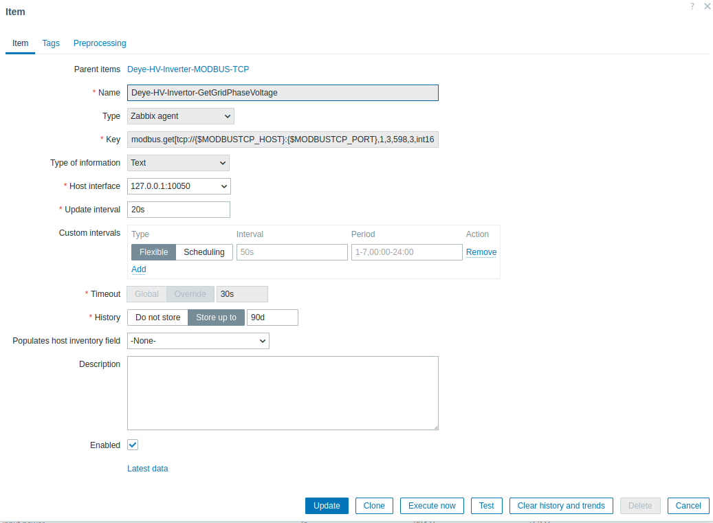

        master item

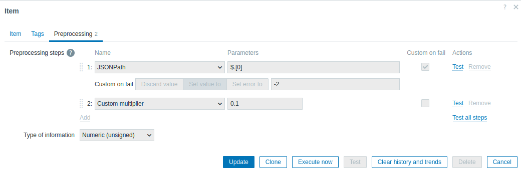

          • 5002
          Looks weird, but same thing is working "in my computer"..
          In your case it fails to identify first element, then sets valued to -2 (custom on fail), then multiplies by 0.1 and saves as unsigned int 0.2.... (shoudl be float, I think, but that does not resolve extracting issue)
          But when I test preprocessing I can get that first number out of [2338,2339,2340] nicely... So I dont really know whats the issue here...

          • troffasky
            • Jul 2008
            • 640
            Looks OK to me....can't explain why Voltage A doesn't work. Does Voltage A never work, or just sometimes?
            Does the log say why that item doesn't work? Some weird s*** like a NUL or some other non-printable character in there?

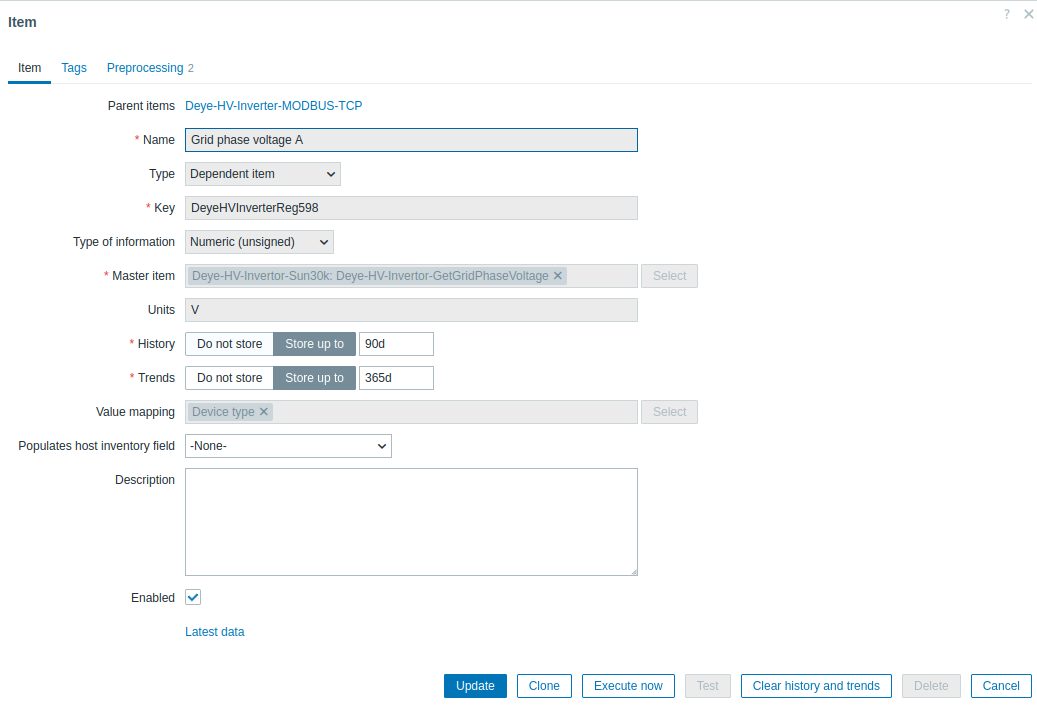

            • piton4ik
              • Nov 2024
              • 17
              I probably created a buggy element, I don't understand how it works but it is, I created another one next to it and it works fine, I need help figuring out what the problem is

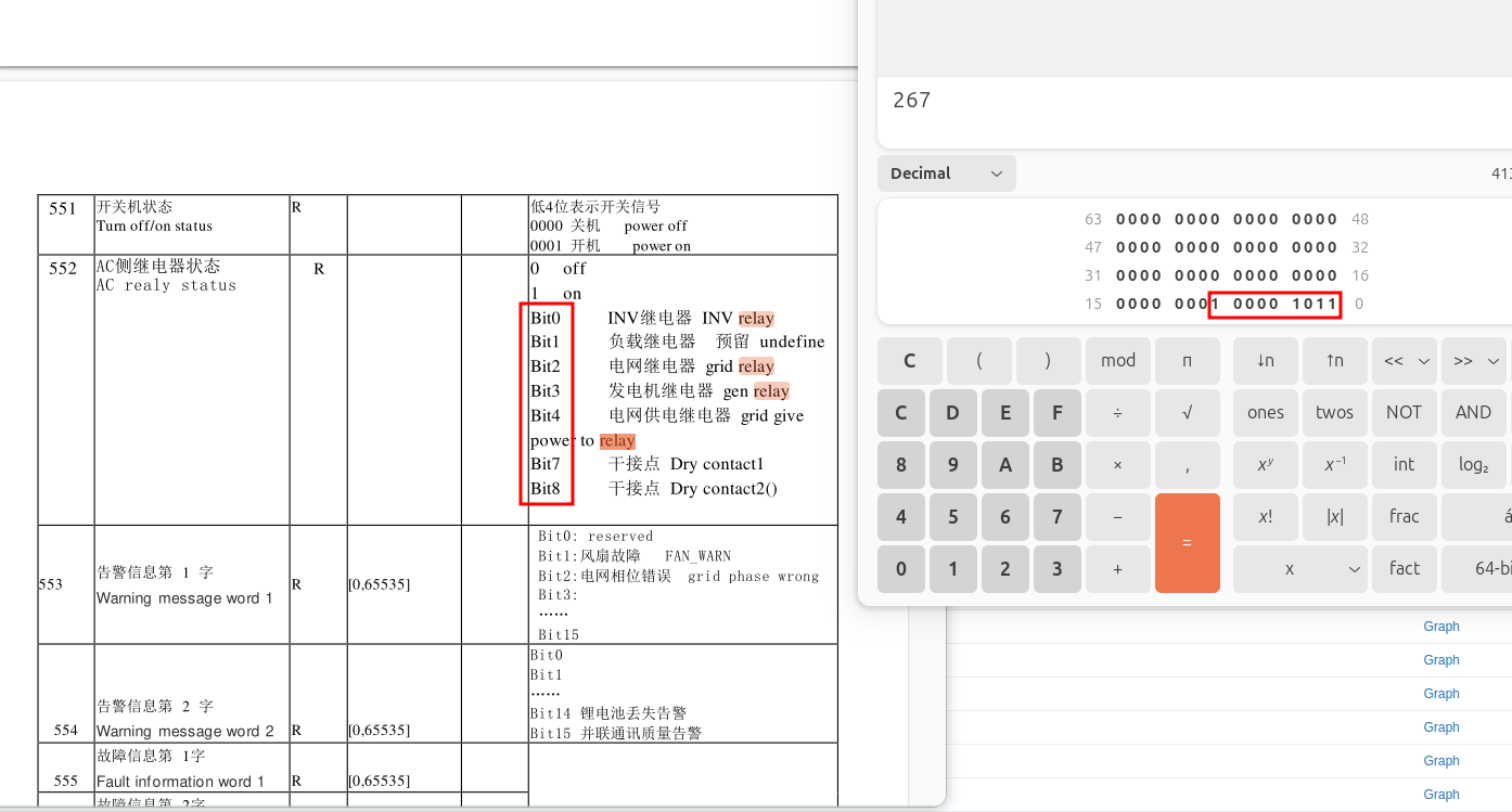

                tell me how to work with bits in zabbix?
                for example, register 552 gives a byte, this is our parent item, the question is how do I get individual bits from this item, bit0 bit1. . bit8
                it's strange that the manufacturer made 9 bits in this register)​
