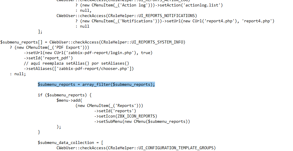

    This isn't a problem with my tool; it's an environment issue. I suggest you open an issue on GitHub if you have a direct problem with the tool.
    That said, the problem with your button is the code's placement; it needs to be above the array.
    Regards.​

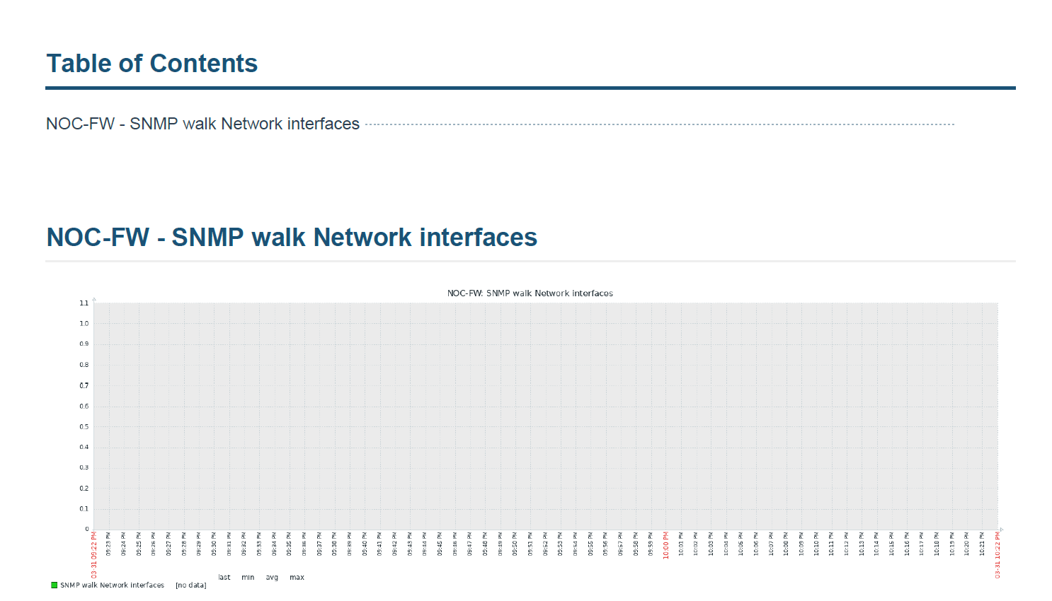

      Hi @AxelDelCanto,
      Thanks for your feedback. I will try to troubleshoot why still get error 404 even i'm already follow the "word" file .
      • kronicklez
        • Mar 2025
        • 54
        #18
        Hi @AxelDelCanto,
        Finally it's work. But i see the pdf generate do not have info except ping result. Kindly please see attachment. If i look by dasboard it have graph/data.
        Appreciate your help.​

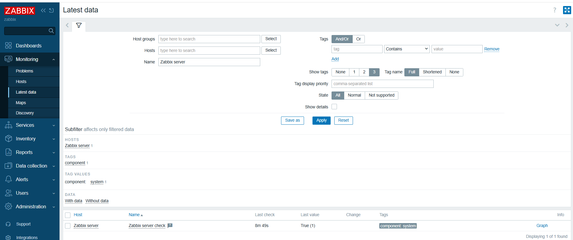

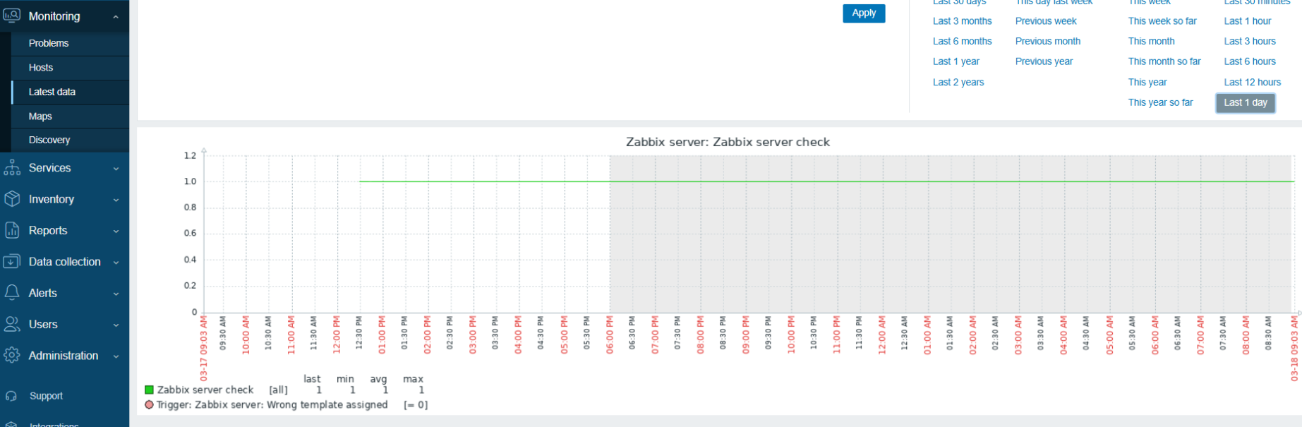

        Hi @AxelDelCanto,
        Is it snapshot below that u want?

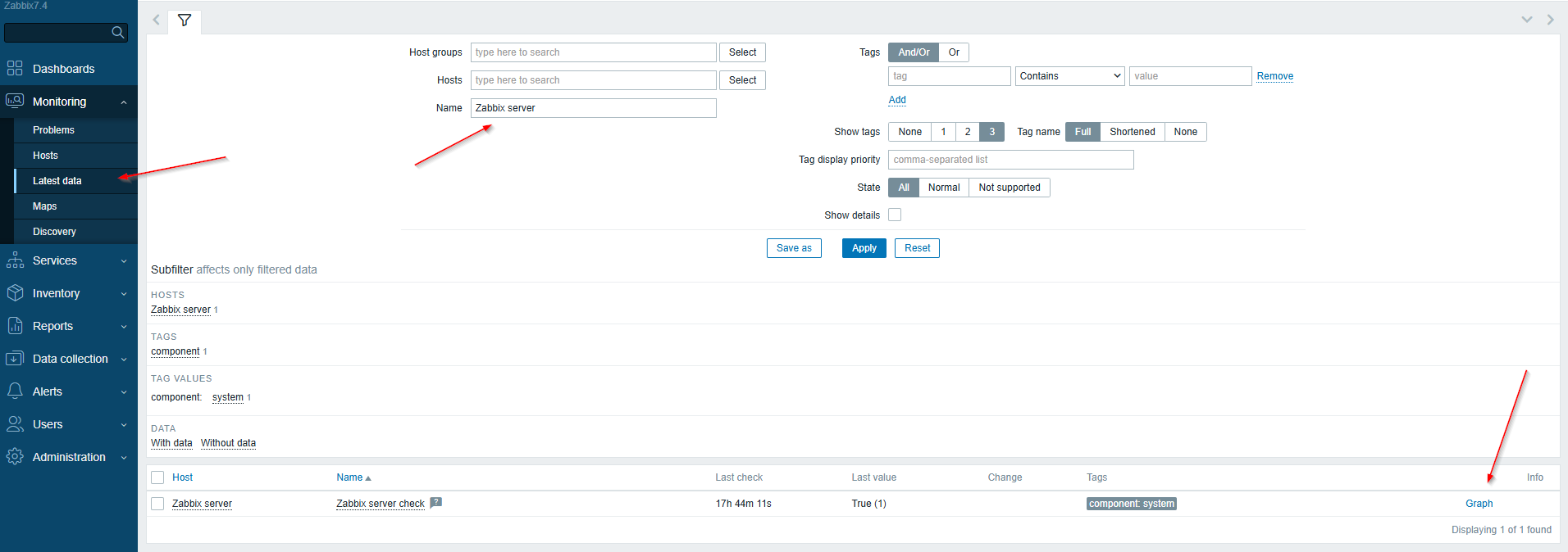

          #21
          Hí kronicklez In the latest data section, search for the server or item name and in the info section select graph. If the chart has no data, you should check the template and/or configuration, or if the chart does not exist, you must create it.

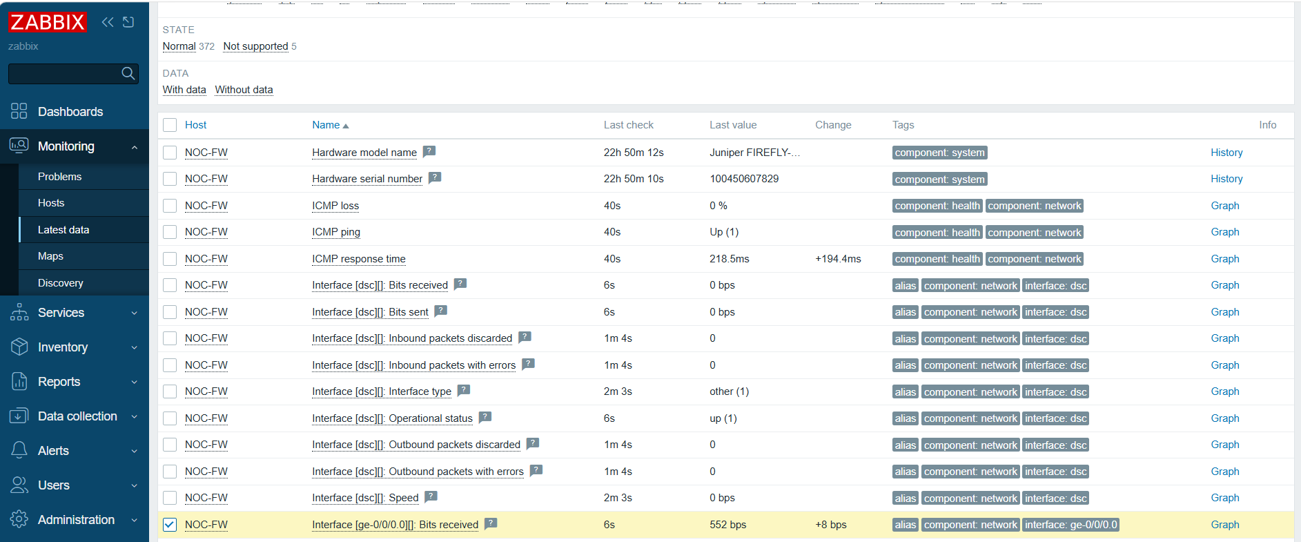

            Hi @AxelDelCanto,
            I can see the chart as per below snapshot.

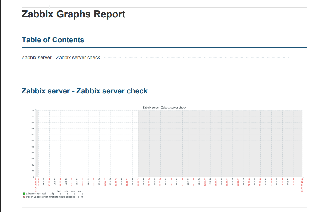

                It's impossible that the graph isn't generating anything because it extracts them from Zabbix itself. I've attached a screenshot so you can see that it works. What I need is for you to send me a photo of the graphs. I pointed you to the "Graphs" tab so you could send them to me, not so you could copy what I did and try to discredit my application. You're not cooperating.
                Furthermore, you're looking for an SNMP Walk item, but you're showing me interfaces. The item you're looking for doesn't match what you're showing. You also haven't sent the graphs for SNMP Walk BGP Peer and SNMP Walk Network interfaces. And most importantly, did you even check if they actually have graphs?

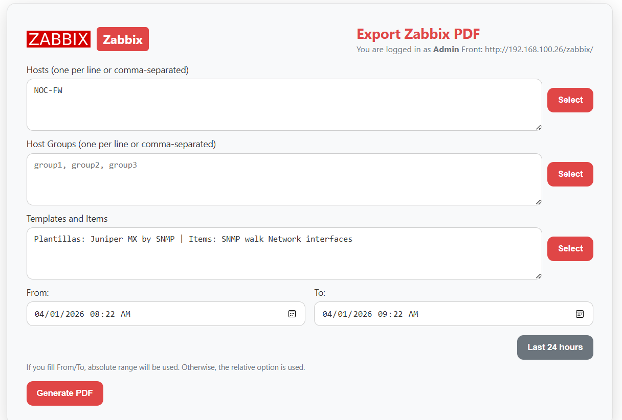

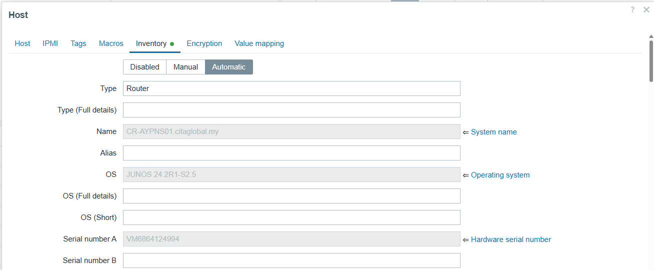

                      #29

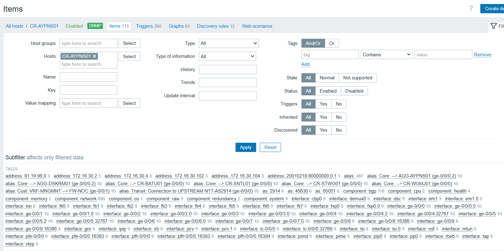

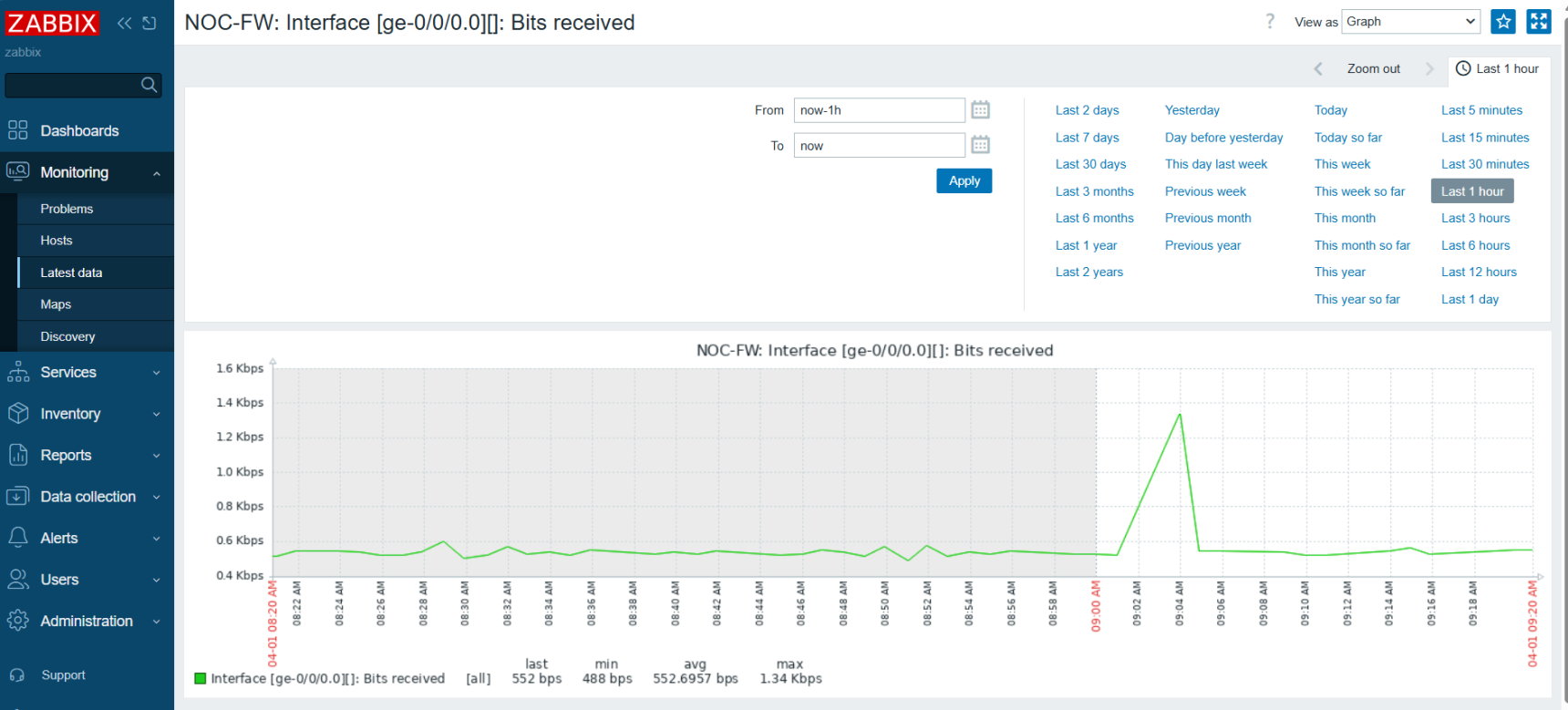

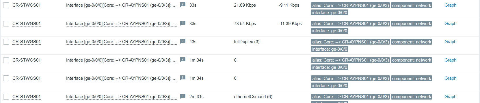

                      Hi @AxelDelCanto,
                      As per your advise below is the snapshot. I'm take on of juniper device that has been discovered. I take 1 hour data. But when generate report still empty. The snmp template is same.
                      • AxelDelCanto
                        AxelDelCanto commented
                        After thoroughly testing the Juniper MX by SNMP template and analyzing how Zabbix handles Low-Level Discovery (LLD) for network interfaces, I've identified the root cause of the issue you were experiencing.
                        The items you were trying to export (interface traffic graphs) are not static items within the template. They are dynamically created by Zabbix through LLD, which means they don't exist at the template level. They are generated per host, per interface, using macros like {#SNMPINDEX} that resolve to real values (e.g., 1, 2, 3) only after the template is linked to a device and discovery completes.
                        My tool was originally designed to work with standard items, not with dynamic LLD patterns. That's why it couldn't find the graphs you were looking for.
                        I'm currently working on a set of improvements to make the tool fully compatible with LLD items across all Zabbix versions (6.0, 6.4, 7.0, 7.4). These fixes will:
                        Automatically detect LLD item patterns
                        Match them with the actual discovered items in your hosts
                        Display interface names in a clean, readable format
                        Properly export the graphs without requiring manual selection of every single interface
                        I expect to push these updates to the repository within the next few days. Once they're live, you'll be able to select interface traffic items directly from the template selection screen, and the tool will handle the discovery mapping automatically.
                        Thank you for your patience and for helping identify this limitation. Your feedback has been invaluable for improving the tool.
                        Best regards,
                        Axel Del Canto
