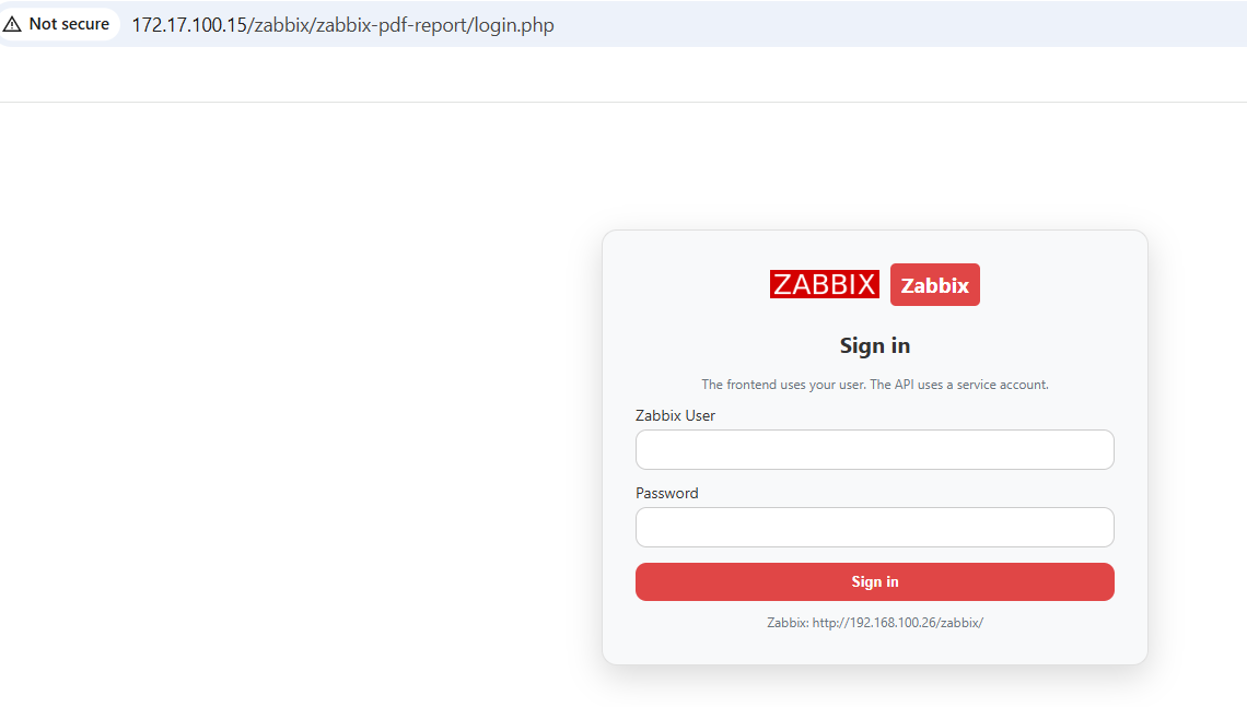

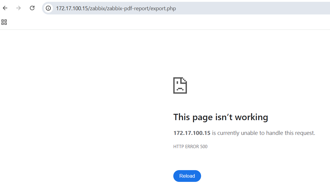

      Hi @AxelDelCanto,
      I'm already replace all that 3 file given into folder "zabbix-pdf-report". After replace when click login it throw error as per belos snapshot. When i replace with original file it can display back to normal after login. Appreciate your feedback

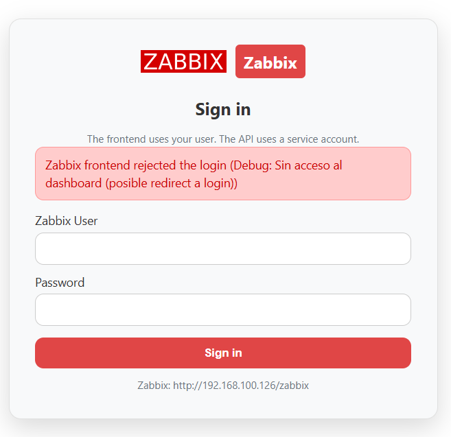

        Hi @AxelDelCanto,
        Not sure it suddenly happen as below snapshot. Even i'm try create back from scractch still get error below. I'm using multiversion.
        • AxelDelCanto
          • Sep 2025
          • 24
          #34
          Hi.
          What you're saying sounds strange to me; perhaps the files got corrupted when I uploaded them here. I uploaded them to Git, and at least I downloaded the complete project and it worked on my Zabbix. Try again.

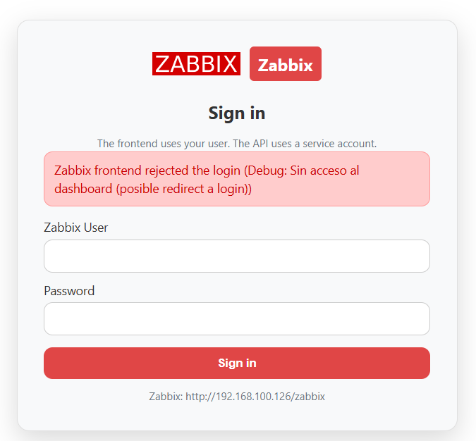

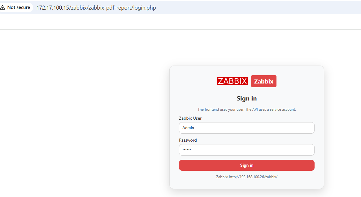

            Hi @AxelDelCanto,
            Its weird in my zabbix. I create back from scratch but it thow error when i try to login as per below snapshot. Do u have idea?

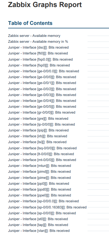

              Hi @AxelDelCanto ,

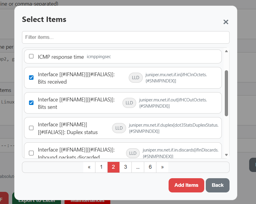

              Just want to update. Now i can see graph from your latest updated. Look like i need to choose the new item that u create not using default item,. Btw, is it possible u can adjust which interface that we want to get data instead it grab all the interface. Thanks and appreciate your feedback.

                #37

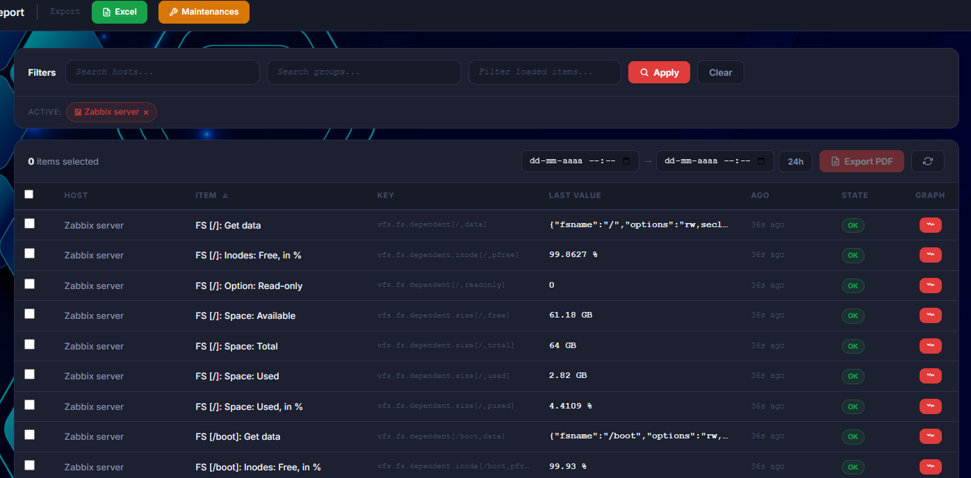

                Hi @AxelDelCanto,
                I think i hit some issue. It look like when we cannot choose item on different page. For example when i choose item on page 2 and try select another item at the page 3 then the item that i already choose on page 2 will uncheck. Could u check on that.

                    • Latest Data Explorer — Browse and filter all monitored items across hosts and groups with real-time autocomplete. Select specific items, preview graphs inline with 6 chart types (line, area, bar, spline, step, scatter), and export to PDF.

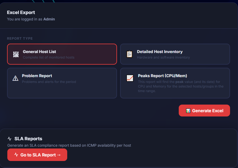

                    • Excel Export — Generate detailed Excel/CSV reports in 4 formats:
                    – General Host List
                    – Detailed Host Inventory (OS, RAM, CPU min/avg/peak, memory, disks, uptime)
                    – Problem Report (alerts and events by period)
                    – Peaks Report (CPU/Memory peak values)

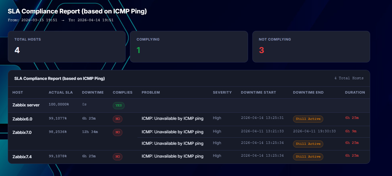

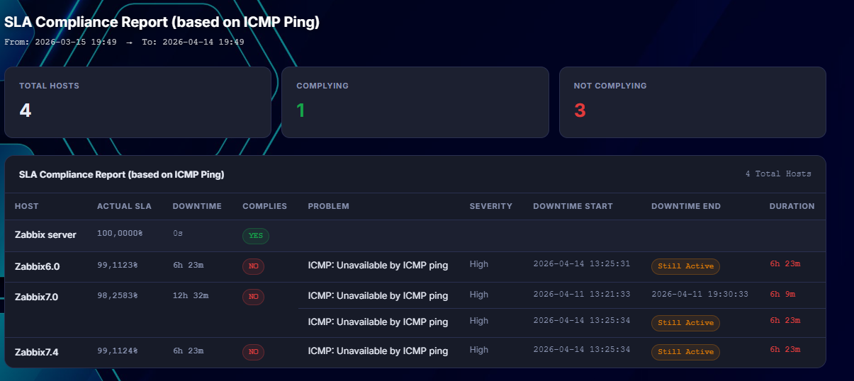

                    • SLA Compliance Report
                    ICMP-based availability report per host. Calculates real SLA%, total downtime, and lists each incident with start/end times. Export to HTML view or CSV. Multi-version compatible.

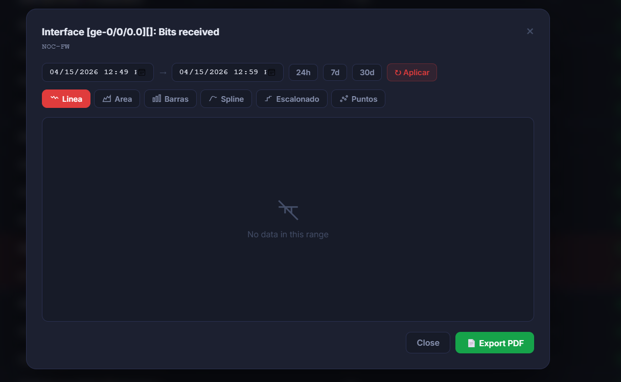

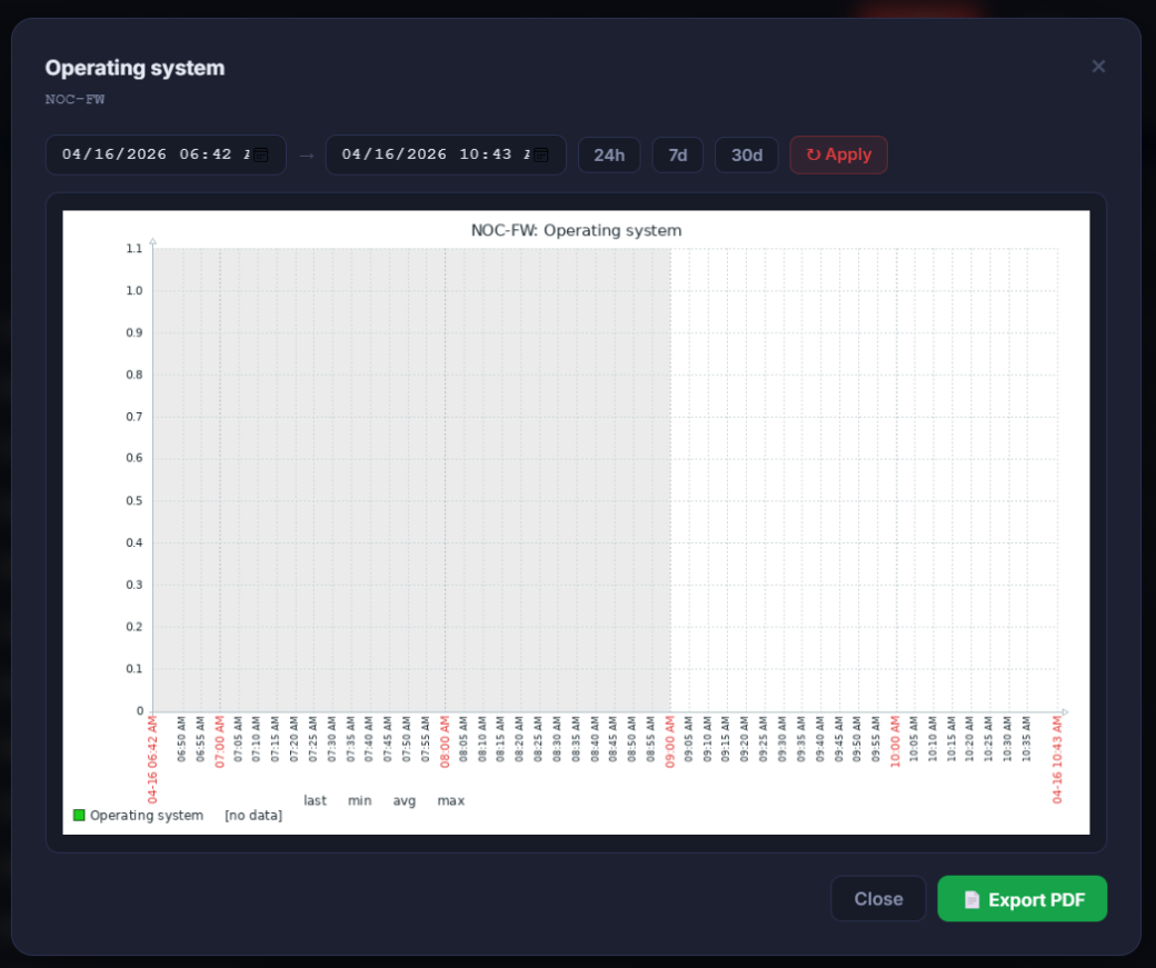

                      First of all your new report look superb. During testing i see some issue. I can see the graph when using normal generate report from your latest tools. But when i try change the output graph as per below snapshot nothing graph appear.
                      Thanks​
                      • AxelDelCanto
                        AxelDelCanto commented
                        I forgot to delete that section; I'm still working on it. I want to be able to extract more granular, Grafana-type graphics. I uploaded a small fix; it replaces latest_data.php and copies /graphs to your installation. The fix is in git.
                        NOTE: Clean browser cache

                      Hi @AxelDelCanto,
                      Noted on that "Next Update: Excel Report". I test on report to excel but not get any value data.
                      • AxelDelCanto
                        Hi, Updated. Replace export-excel directory.

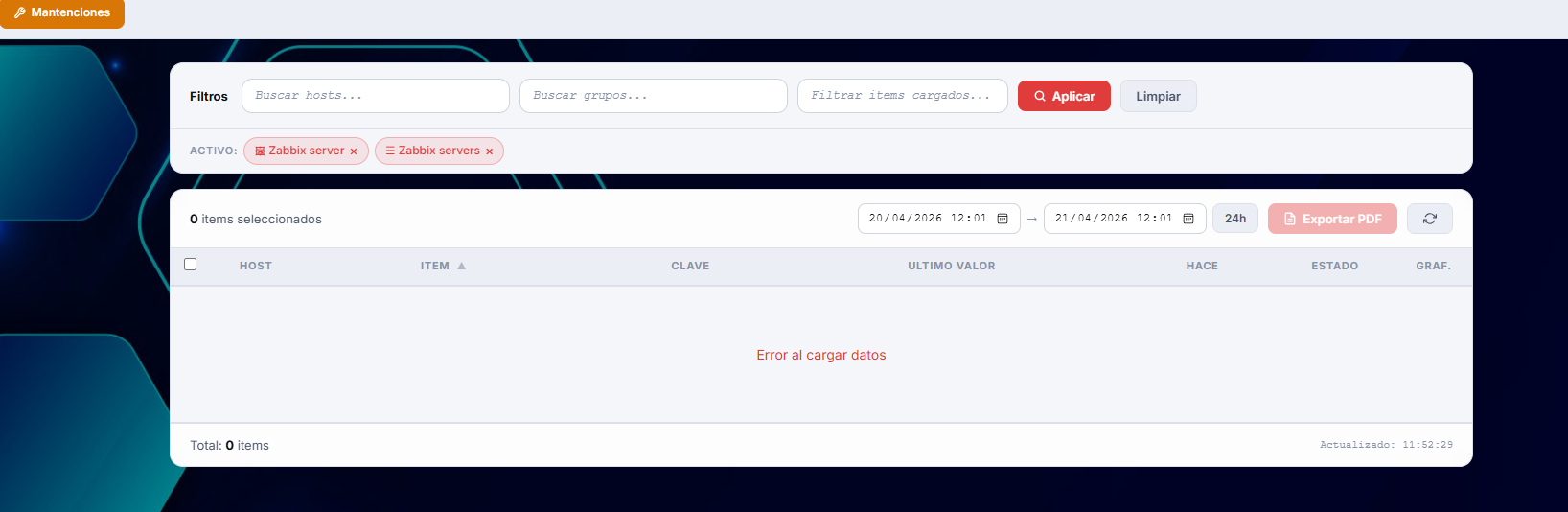

                      Hi AxelDelCanto,
                      Thank you for your work. I am testing the app and I get this error after the query started:
                      Then I checked zabbix apache2 logs and:
                      [Tue Apr 21 12:01:21.121033 2026] [php:notice] [pid 1821476] [client 192.168.1.31:48725] ZabbixApiFactory: Versi\xc3\xb3n detectada: 7.0.24, referer: http://172.16.2.11/zabbix-pdf-report/latest_data.php
                      [Tue Apr 21 12:01:42.248670 2026] [php:error] [pid 1821476] [client 192.168.1.31:48725] PHP Fatal error: Uncaught RuntimeException: [API HTTP] Operation timed out after 20002 milliseconds with 0 bytes received in /usr/share/zabbix/zabbix-pdf-report/lib/ZabbixApi.php:50\nStack trace:\n#0 [internal function]: ZabbixApi->rpc()\n#1 /usr/share/zabbix/zabbix-pdf-report/lib/adapters/ZabbixApi70Adapter.php(74): ReflectionMethod->invoke()\n#2 /usr/share/zabbix/zabbix-pdf-report/latest_data.php(147): ZabbixApi70Adapter->call()\n#3 {main}\n thrown in /usr/share/zabbix/zabbix-pdf-report/lib/ZabbixApi.php on line 50, referer: http://172.16.2.11/zabbix-pdf-report/latest_data.php
                      Thank you.

                      • Xenon032
                        Xenon032 commented
                        Hi AxelDelCanto Thank you, It works like a charm now. My environment has like 30K+ items, 200+ hosts. I'll try export some pdf reports with many hosts, items and long time ranges. I'll let you know my feedback!
                      • AxelDelCanto
                        Hi @Xenon032
                        I'm glad the fix worked. If you encounter any errors, please leave them in the comments so we can analyze them. I also encourage you to leave a star on the Git project page so more people can access the tool.
