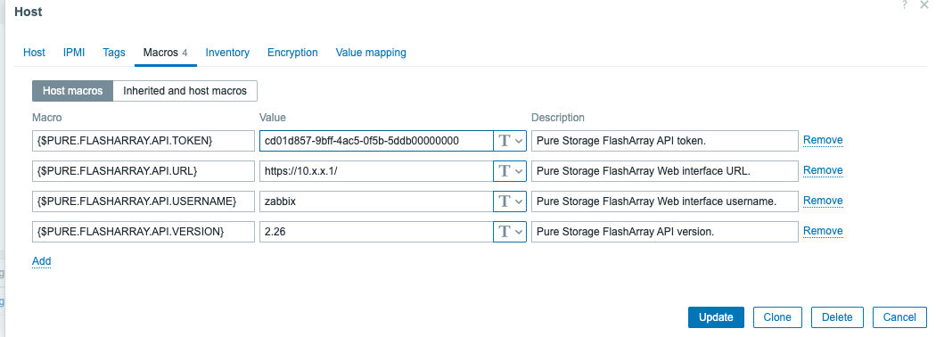

    I am new to Zabbix and new here so maybe i just struggle because i dont know how things work. For example: it took me a moment to not press seleect but search for the template. I did try a fair amount so i maybe its not me
    My goal is to see if Zabbix is the product for us to use for monitoring and reporting. We currently use CheckMK but it was configured by others and uses quite some custom plugins to monitor storage systems. I installed 2 VM's: 1 as the main server and 1 proxy to be used at customers sites. Both run 7.0.38 LTS of Zabbix on Ubuntu 24.04.
    We work a lot with Pure systems so my first goal is to see how i get one of our local pure systems working.
    I have created a read only user on one of the puresystems, created an API token key and then configured a new host in the data collection. For this host / Pure system.i have selected the "Pure Storage Flasharray v1 by HTTP" template. Then i configured 4 macro's :
Name:	Screenshot 2026-04-01 at 14.16.23.png

    I did try some variations of the URL:
    /API
    API/
    API/2.26
    API/2,26/
    None seem to work.
    When i check the items i see an red i with the following: Preprocessing failed for: {"array":{},"error":"Unexpected cookie value has been received: Failed to receive data: invalid r...
    1. Failed: cannot extract value from json by path "$.array.space.total": no data matches the specified path
    this happens with both V1 and V2 templates. I also seem to have trouble to find the V2 template on the website.

        I have some pure storages being monitored by this template. The only difference that I can spot is that I didn't set any value for the macro: {$PURE.FLASHARRAY.API.USERNAME}
        I'm not sure if this could break the template, but it does use a lot of JavaScript preprocessing with a bunch of checks against the macros... Maybe it checks if this macro has some value and if it does it tries to authenticate using user and password instead of token? It' just an wild guess, but it may be worth trying if you haven't yet.
        Last edited by kyus; 23-04-2026, 13:41. Reason: I had previously mentioned the wrong macro {$PURE.FLASHARRAY.API.URL} instead of {$PURE.FLASHARRAY.API.USERNAME}

          @kyus: that is interesting, how does Zabbix know what to monitor? What did you set to point towards the array? I managed to get mine working with the URL: it should be: https://<array name or IP>/ . I also used a lower API then i was expecting: the array is running an old Purity (6.5.4) but 2.26 was the latest on that. I configured 2.21 instead and that helped too.
          I hope this information helps others! I am today going to test on an updated array (6.9.3) to see if i get it working.

            I used the URL macro to point to the array. I just wrote the wrong macro on my previous comment. I meant to say that i didn't set anything for the {$PURE.FLASHARRAY.API.USERNAME} macro.
            In fact, this macro doesn't exist in the template I'm currently using, which is called "Pure Storage FlashArray v2 by HTTP". And I also can't seem to find this template anymore in Zabbix Git or the integrations page.
            Maybe the only difference between versions was the authentication methods and it was unified in a single template? I'm not sure, but I guess you can try to use only these macros:
            {$PURE.FLASHARRAY.API.TOKEN}
            {$PURE.FLASHARRAY.API.VERSION}
