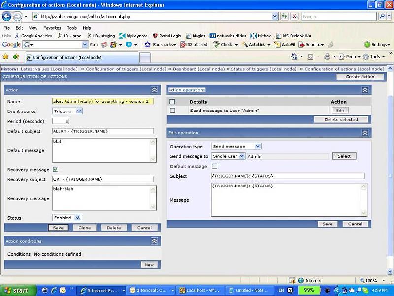

      OK, I hope I understand more now. I *do* receive recovery message, but it's the same message as for alert.
      I played with both "Default subject" and "Recovery subject" under "Action" tab and with "Subject" under "Action operations", but without success.
      BTW, I don't understand what is relationship and difference between "Action" and "Action operations?
      I want pretty trivial thing:
      1) to receive alert email when any trigger goes ON
      2) to receive recovery email when this trigger goes OFF.
      See attached screenshot for my configuration.
      thanks
      Vitaly

        I had the same problem
        I also received the same messages when trigger switched to ON and OFF. In "Action conditions" I set the normal conditions (Trigger = "blah blah") and TriggerStatus (or something similar in English, because I'm using German locales) = ON.
        So if you check "Recovery Message", you will get the recovery message if the TriggerStatus switch to OFF.
        If you checked "Default Message" in Action operations, you will get the default messages and subjects you defined in "Action". Otherwise you can type a custom message in the text field below the "Default Message" checkbox.

            That was the workaround
            Hello and sorry for my bad english which is hard to understand...
            When I was starting to play a bit with zabbix, all my Actions had only one condition:
            Triggername=<Name of the trigger>.
            I noticed that, no matter if I checked "Recovery Message" or not, zabbix sends 2 messages with the same content. The content came from "Default Subject" and "Default Message". After some time I tested to add a condition:
            Triggerstatus="ON" (linked with "and" to the other condition).
            Now, zabbix sent only one message (if "Recovery Message" wasn't checked). After checking "Recovery Message" I got a additional message with content from "Recovery Subject" and "Recovery Message", when the trigger goes to OFF state.
            So I just added this Action condition and all worked fine...

              Many thanks! "triggerstate" in condition was this missing piece!
