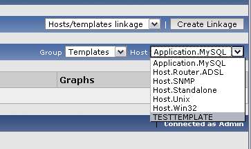

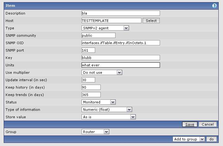

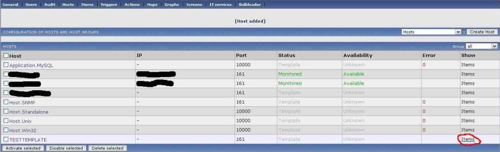

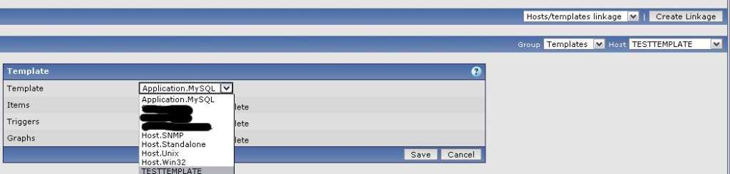

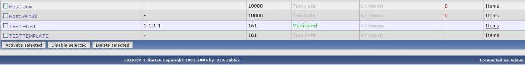

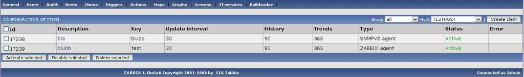

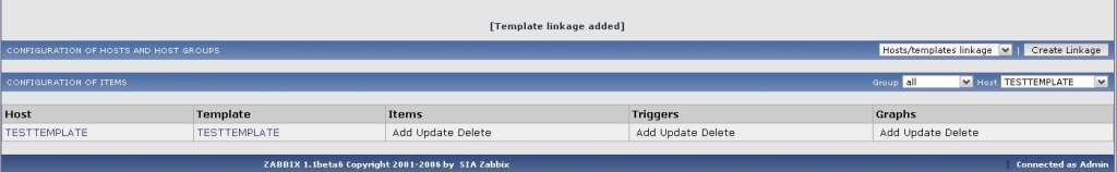

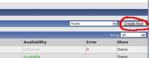

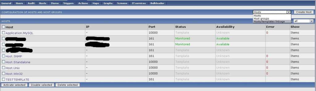

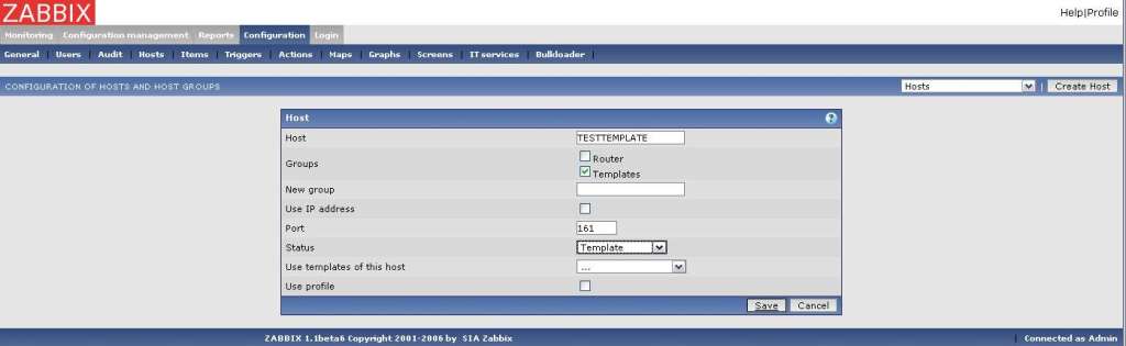

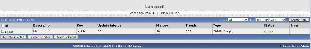

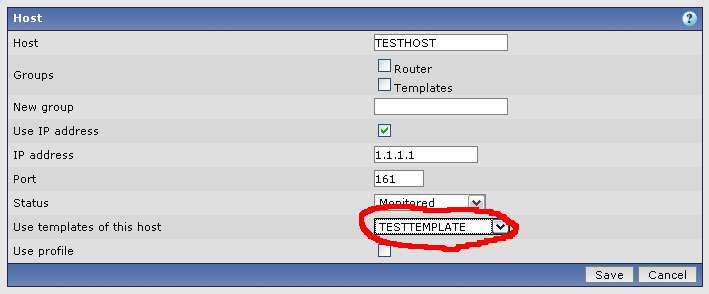

              Please wait, i have made some screenshots. The images are numberd from one to twelve. Please look at the images and do the same with your values.
              • krusty
                • Oct 2005
                • 222
                Sorry for my 3 posts but i only can upload 5 images at the same time.
                no 6 to 10
                • krusty
                  • Oct 2005
                  • 222
                  And the last two images. I really hope this help you.
                  Try it.

                    Thank you for patience. I can't understand that I must linkage testtemplate with testtemplate.
                    Now I got what I want. Thank you.
