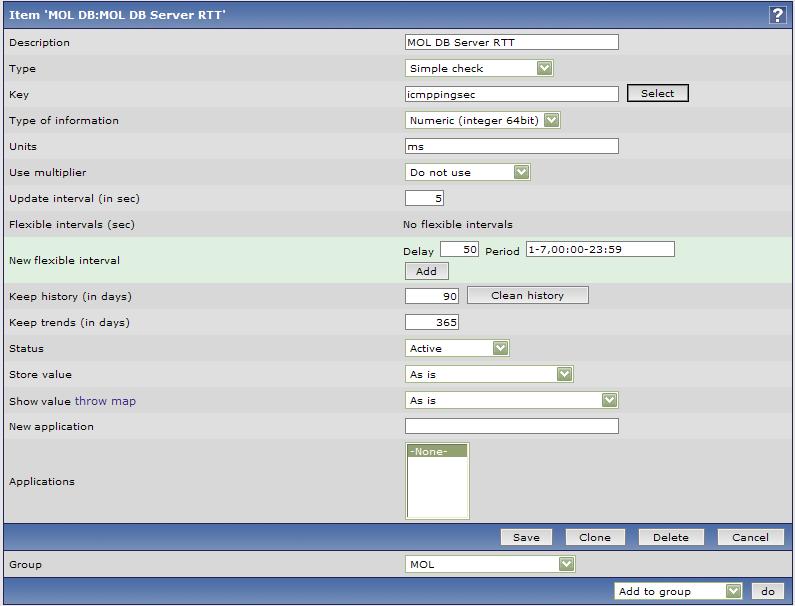

                          • cgroothius
                            • Sep 2008
                            • 37
                            Hope this is right...
                            • richlv
                              Zabbix Certified Trainer
                              • Oct 2005
                              • 3112
                              #15
                              try setting type to numeric (float). and, of course, increasing period - 5 seconds is damn often, you'll overload the server soon
