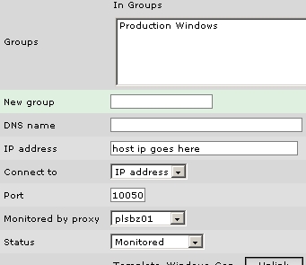

        So far I have tried all that with no luck and I feel I just missing something simple that I am over looking. The main issue I am having right is is when I switch a host to be monitored by the proxy in the gui it never changes to offline even if the nic is turned off or even on a different subnet. I have updated the time from two hours to 2 mins but even that doens't matter since last night I moved the proxy from one subnet to a different one than my test machine was on and in the gui it never updated. So my direct questions are the following:
        1. how does the main server know to receive the data from the proxy since there is no way to set any info except a name?
        2. when adding a host that will be monitored by a proxy what ip do you use the proxy or the actual ip of the machine?
        3. can the proxy be on the same subnet as the main server for testing?

          1. In the proxy config you set a server hostname/ip address. This is your main server. The proxy 'name' should be configured in the proxy config and the main server (this is the identification).
          2.Clients should have the proxy server configured as 'server'
          3. yes this should pose no problem.

                          In the gui on the server do you put the ip of the host or the proxy when you are adding them in as a host being monitored by a proxy.
                          Here is the agent log from the host:

                            You set up the host as you normally would, entering the host IP. The only difference is that you select the proxy from the dropdown list of "Monitored by proxy"

                              #15
                              Thank you!! have been asking that one for a bit now
