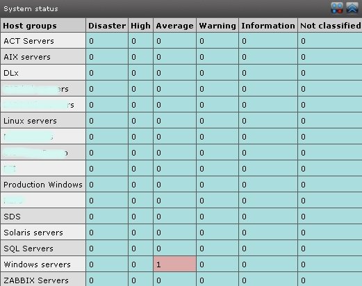

          What kind of alert are you talking about? Just seeing in the GUI that the server is unreachable, or are you expecting an e-mail alert?
          Instead of shutting down the NIC, just stop the zabbix agent on the host for a few minutes. You should then see in the Zabbix dashboard that it shows up as a red spot under one of the severity columns.

            #20
            Yes just seeing the "server is unreachable" I have not reset up the actions on the install so I know I wont get an email. As for shutting off nic is easier due to it is a laptop that I have sitting next to me and it is just a switch to turn it on or off. When I was testing it with out a proxy it worked and it was faster. I have left it off for sevral minutes with the "server is unreachable" on the dashboard and under the host it still shows it is online
