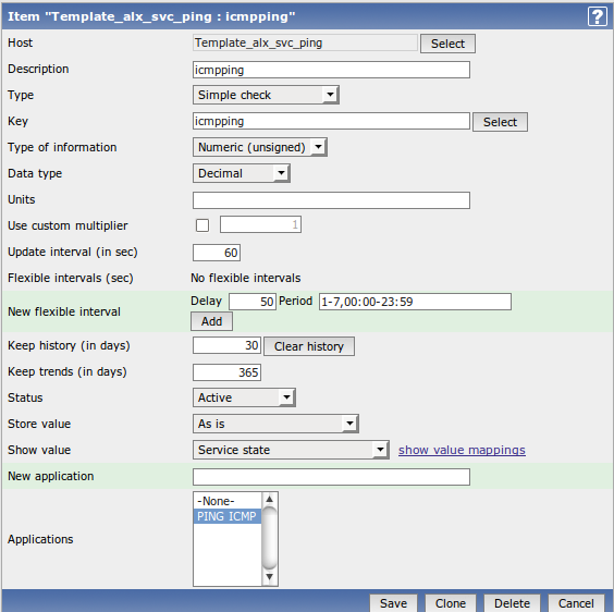

          • alixen
            • Apr 2006
            • 474
            You can use icmpping as key. No need of [,,,].
            Also, 1 second update interval seems too aggressive.
            I have attached a screenshot of my icmpping setup.
            I use a 60 s. period and it is working fine.
            If you want smaller update interval, I suggest that you don't go below 5 s.
            Regards,
            Alixen
            http://www.alixen.fr/zabbix.html
