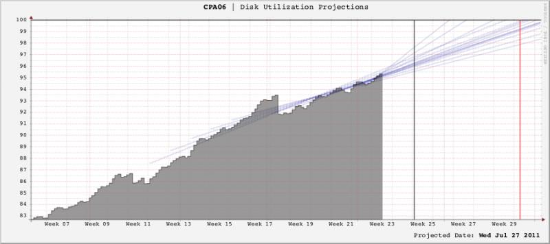

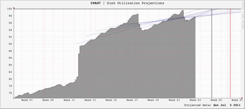

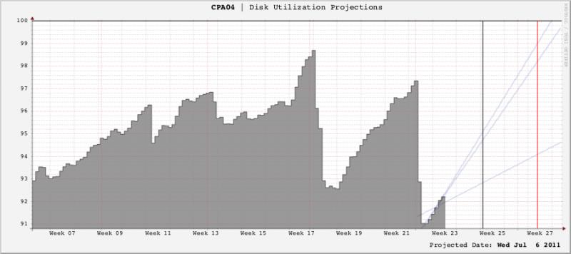

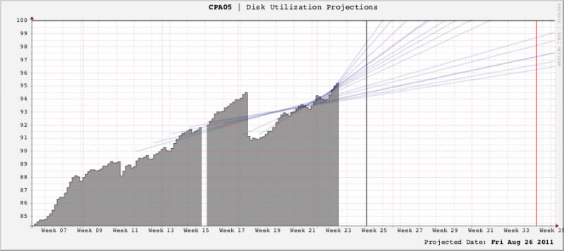

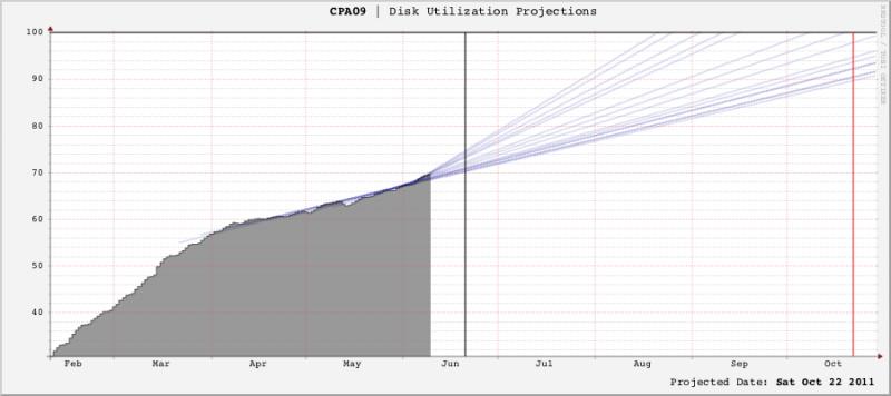

    I think almost everyone would find it very useful to be able to monitor and report on projected time to hit a specified threshold (x days of available space). The problem (for me) is the projection part, specifically the math. Determining a single projected date is tricky. I have done some work like this a few months ago and used rrdtool's LSLSLOPE function. LSLSLope is one of the formulas that can provide a trend line and rrdtool provides it in a way that was easiest for me to use.
    Basically, I plotted many LSLSLOPE lines, each starting from a different point of time in the past. Each would provide a projected date. I would get a single final projected date by taking the average of them all (weighted towards the more recent trend lines). The amount of history for any given volume is a big factor in determining a realistic date.
    It would be worth it at some point in future for me to integrate this into Zabbix. It's a matter of exporting historical disk utilization data, creating an RRD with that data, getting the projected data (as described), send that date to a Zabbix Trapper item.
    Kludgy indeed, but I know this would work. I would probably just do it every 12 or 24 hours per volume as well.
    I attached RRD graphs that show a bit of how it's calculated. Notice in the lower right corner there is a final projected date (also represented by the vertical red line). The grey vertical line is just the current day that the graph was run on.
